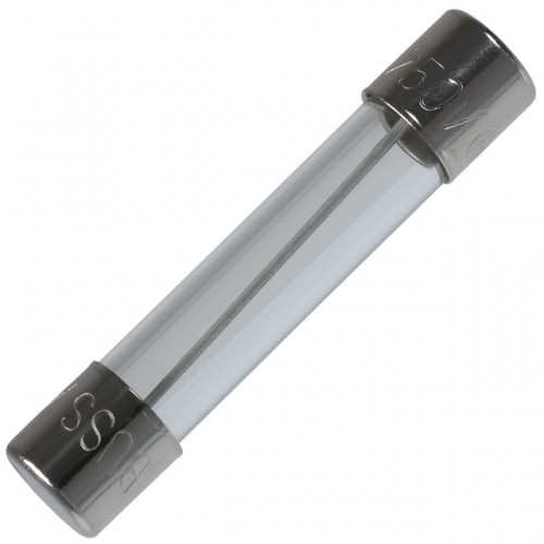

So i have this multimeter, the APPA67, but the fuse is blown. I can't find a new one can anybody help me? please.

You can use any 1A fuse that is:
Rated to 240V or more
Is considered "fast"
The same physical dimensions​
Is this a 1/4" glass fuse like this?

Well the story is a bit different because i got the mulimeter from a friend and the fuse wasnt in it, so i dont know excactly how it looks. But there is a 2nd fuse inside wich is ceramic and 10A i figured the other one also would be ceramic or is it just me? I am a little new to electronics so i dont know everyting

...so i dont know excactly how it looks.
Can you take a picture with a ruler in the frame? If it's like the one in the picture, it's about 1-1/4" long and 1/4" in diameter, or 32mm x 6.3mm. But it could be many different things.
I wouldn't worry too much about whether it's glass or ceramic. It's the functionality that matters.

Well its a bit late right now but tomorrow I will make a picture, i think the length was about 25mm but i didnt check the hight

yes that one should work out fine, thank you so much
but there is one problem, this site asks 20 dollars shipping and i am not going to do that
I have found one but it says super fast instead of fast does that really matter
