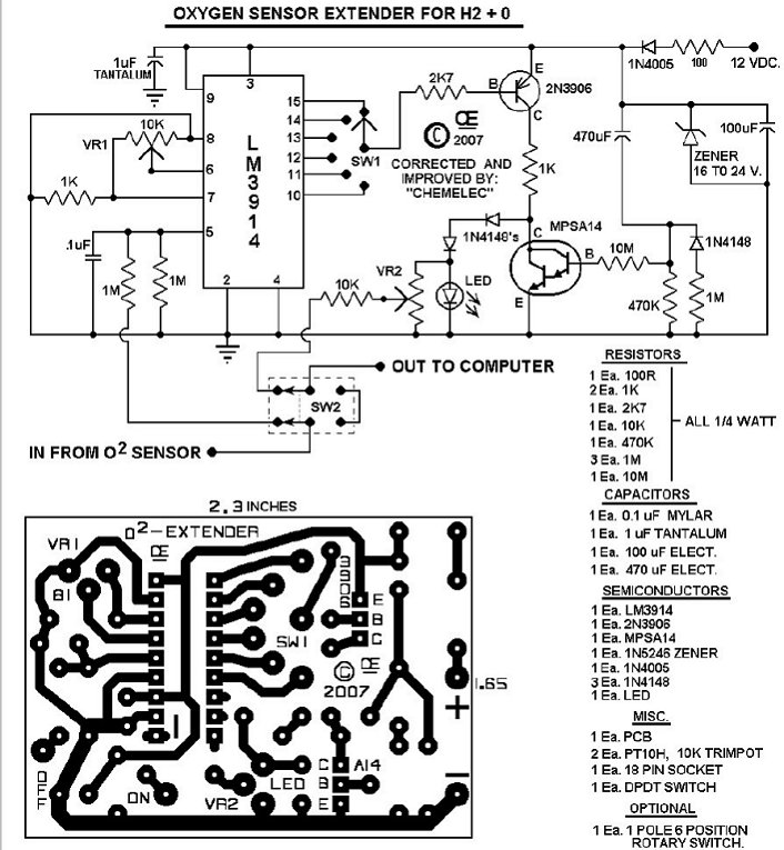

hey linchiek, if your car is a late model one with injection and computer controlled systems and such, it will probably have a oxygen sensor on the exhaust system, detecting whether to increase the fuel mix or to lean it off. Because HHO actually introduces more O than the system is set for, that extra O---oxygen---for those that need to be told...will make the computer think it need to enriched the fuel mix going to the engine. If that is the case, which I think it is, you will need to add a EFIE..to bluff the Oxygen sensor circuit into letting the engine run as normal and not on an enriched fuel mixture, then you will see and improvement in your fuel mileage.
The basic essentials for a successful HHO system are 316L stainless plates, a PWM to control the amount of power being delivered hydrogen generator and a EFIE...electronic fuel injection enhancer, or otherwise called a oxygen sensor simulator...then you will have success...
let this be a short note to other doubters out there....HHO is here to stay and it does work.......ok..
Elad
Joined Jul 1, 2008
11
Above is a circuit to trick your computer and lean out the engine, but requires each one for each O2 sensor.
My 97 Toyota Avalon XLS has 3 O2's :(
Instructions for this circuit is here: http://www.free-energy-info.com/D17.pdf
(Note that the schemetic above is a newer version than in the pdf file...)
For me, am only going to try this circuit below 1st and remove/ignor the check engine lite :)
Another guy up here has installed his Smacksbooster and is only doing this circuit shown below to lean out his oldsmobile to the point where is starts to run bad, switches on his HHO (apx 25 amp draw when warm) and engine smooths right out. So its doing something. :)
He's yet to run a tank of fuel as only lives a few miles from work.
