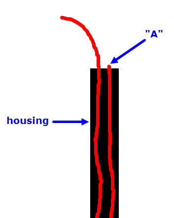

hello :) recently i noticed that my brake light isn't working when i pulled the brake lever in my bike. i just checked around the brake light switch and discovered that one of the two wires was broken.
if you refer the below rough sketch,
the two wires come through the housing. one wire was broken at point "A". so i have no space to strip the wire and solder it with the broken part. i think i need to split the housing with a paper knif and then strip the wire and solder. but this is a factory wire harness and i'm not happy to split the housing. so i decided to ask it here from some experienced people. do we have any other option to solder it without damaging the housing ? if you have any opinion please let me know. thank you :)

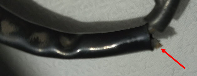

thank you :) it's hard to manipulate my phone around that area to take a photo. but finally managed to get one. hope it's clear. the part shown by the red arrow is the broken wire
that housing is a tube type one. not a split or wrapping type one. otherwise i could have soldered it without any issue. also that broken wire is very stiff. i mean not flexible like a new wire. hope i can strip it without any problem. thx again.

I work on motorcycles and this happens now and then. Just because it's factory or oem doesn't mean it can't be done better. Split that sucker open, remove the insulation and solder in a new section, heat shrink and make sure you account for funny bends, friction or pivot areas. If there is pivoting happening, go further down and consider crimped bullet terminals instead of solder which is brittle

yea. i think i have to split it as you said. then solder and heat shrink. after that have to use an insulation tape to wrap the split part. this area is always exposed to water, dust, warm/hot weather. that's what i bother. hope it will last long. thank you :)

Can you get to the other end of the tube and pull the wire back through? Pull it out, lengthen it and then feed it back into the tube? Then make your external repair.

checked inside the handle bar switch assembly. there was no space to pull it back. so have to split it. thank you :)

If it is that stiff, to me it would be better to replace the wire instaed of splicing it. If it broke once it will break again on the other side of the splice. Is this even multiple strand wire or just a single strand?
thank you :) yea i stripped it and could see some oxide ( green/blue color ) on the strands. i just removed them with a paper knife. wire is something like this. is this called a multiple strand wire ?

ok. i did it. split the housing a bit then soldered and heat shrink the wire. after that wrapped the split part with an insulation tape. brake light works now. thank you :)
