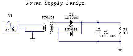

I'm a bit late joining in but here is my input for whatever it is worth.
Power Supply Design is standard fare in any Introductory Electronics Course. Just to make sure that I can remember how to do this I have done the following:
(1) Do the simple math.
(2) Check my results via simulation using CircuitMaker.
(3) Measure actual results on a test circuit.
The test transformer is a Hammond 165P25 CT 5A weighing 5.5 lbs.
Hammond is known to make reliable transformers that are conservatively rated. The voltage specified is the voltage out at full load. No-load voltage on this transformer is 27V.
Ok, let's do the math. We could do a rigorous mathematical analysis but there is no need. (See Post #21 for the mathematically inclined.) A simple first order approximation will give us good results.
Let us make the following assumptions:
Vac = transformer output at rated load = 25V
Vdiode = diode drop = 0.7V
C = filter capacitor = 0.01F
R = load resistor = 10
f = line frequency = 60Hz
Vac is the RMS value from the transformer. For fullwave centre-tap rectification, we divide this by 2 and multiply by square-root of 2 to give peak voltage. Then we subtract the diode-drop Vdiode.
Vdc = Vac*1.414/2 – Vdiode
Substituting the above values give us Vdc = 17V
Now we calculate the average load current:
Iavg = Vdc/R = 1.7A
We make a simple approximation that this charge must be supplied by the filter capacitor during one half-wave cycle. This time duration is one-halve the period of the mains frequency.
T = 1/2f = 0.0083 s
The charge supplied during this time is the average current multiplied by the time.
Q = T * Iavg = 0.014 Coulomb
Hence the voltage on the filter capacitor will drop by:
Vripple = Q/C = 1.4V
Now we need to calculate the peak diode current. To do this we have to estimate when the diode is turned on.
The voltage into the capacitor is
V = Vdc * sin(2*pi*f*t)
The capacitor will begin to recharge when the sine wave exceeds the load voltage, i.e. when
Vdc – Vripple = Vdc*sin(2*pi*f*t)
we solve to find t
t = arcsin(1 – Vripple/Vdc) / (2*pi*f)
This is the point approaching the peak of the sine wave when the diode starts to conduct.
This calculates to be about the 67 degree mark or 3.08ms.
We make the assumption that the diode conducts from about 67 degrees to 90 degrees,
that is, from 3.08ms to 4.16ms = 1.08 ms
tconduct = 1/(4*f ) – t
Assuming all the charge is replenished during the turn on time, we can calculate the peak diode current if only we knew the shape of the current pulse. In the best case, if the shape is rectangular, the area of the rectangle is given as
Q = Ipeak * tconduct
Ipeak = Q/tconduct
Ipeak = 0.014/0.00108 = 12.96A
If we approximate the shape of the current pulse to be triangular then Ipeak will be twice = 26A.
There you have it.
