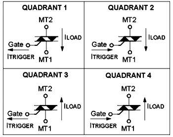

just noticed ? "3W LED bulb" . . . doing some math : 3-ac has 1.5 V ON-drop at (? ... 12V 21/5W ≈ 2A) , 3W / 240 V.RMS ≈ 12.5mA.RMS ← it is just about the Hold Current of your BTA/BTB06-xxxTW variant /!\ but also the range of gate control current (5mA for 'TW variant ← you likely have to route this in parallel with your load) . . . but that 5mA will be extracted from 12.5mA.RMS 17.7mA.SineAmplitudeValue ← it is a challenge to put the thing condugting just near/below it's ratings
____
& don't miss the -- #18
the quadrants are different + some may require control voltages below V.T1 (Cathode)
← i guess they have Q.1 and Q.2 labels swapped here /!\ (about detailed)
src. :: Designing MCU applications for use in high voltage environments: Part 2 - Embedded.com

Non-insulated SCR / Triac control circuits Application note AN3168 ← has the correct quadrants' labelling
