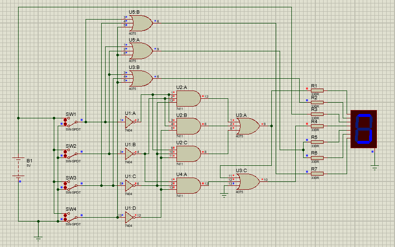

There is 4 bit input A,B,C,D inputs.As output we have 7 segment display.When only A is 1 will display 6 , when B 0 , when C 3 and when D 8.
When 2 or more inputs are 1 will display H.
How do I design this circuit using less ICs, and using only Logic Gates/Multiplexer/Demultiplexer/Coder/Decoder/7-Segment driver IC?

Thanks for your comments.Sorry for bad description about problem. I must design the circuit of problem described above. I can be done using
only logic gates ic's and using 8 of them. I'm looking for an another approach , if it can be done using 8< ic. Here's outputs:

Thanks for your answer and yes its a homework. I've put "x" to the outputs when all inputs are "0" and total ic used is reduced to 5.
But when all inputs are "0" a,c and d led's are blinking.

I've put "x" to the outputs when all inputs are "0" and total ic used is reduced to 5. But when all inputs are "0" a,c and d led's are blinking.
Show your work for the equations for segments a, c, and d. Post your schematic.
If you care what a, c, and d are when all inputs are LOW, you shouldn't use that row as don't care.
I see that you've put a tail on the 6, but you don't show the logic simplification that would give.

I think the states of a, c and d its not necessary since our teacher not referred to it. I will apply it on pcb. Here is the circuit:
That might be a poor assumption. Some teachers might omit important information to see if students are paying attention.
Your image didn't show up until I quoted it...
Here's an edited version:
Haven't checked the wiring/logic yet.

Post your Kmaps for segments 'a' and 'd'.
How can segment 'c' blink? You have it connected to the power supply. Which counts cause 'a' and 'd' to blink?

I reduced the ic number to 5 without blinking a,c and d when all inputsa re "0". It's enough for me . I think the problem is solved. Thanks for your help and sorry for wasting your time. :rolleyes:
