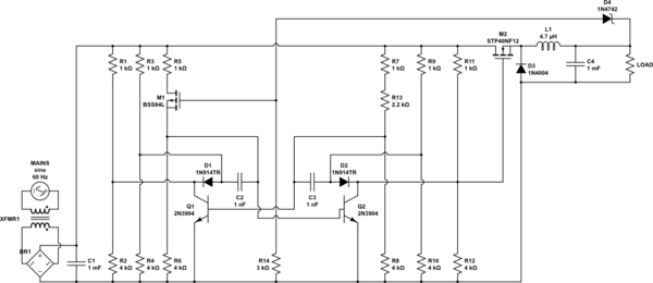

There are still probs with your circuit (so far as I can make it out, it being so small):-
The bridge rectifier seems incorrectly oriented.
Both M1 and M2 seem to have source and drain reversed.
How do you get M2 gate several volts above its source to turn it on?

I noticed the bridge rectifier issue. I corrected it in an updated diagram but haven't posted it yet. I also noticed the the zener diode has no DC path to ground, so there never will be an input on the gate. I'll be changing the position of R13 to accommodate that.
I don't think they're reversed?
What do you mean by "How do you get M2 gate several volts above its source to turn it on?"

Okay, so you were right. @Alec_t, I switched the MOSFETs around. I also gave the zener a path to ground. In addition, I also switched the inductor and diode...so now It's actually a buck converter.
The last problem I've heard mentioned is that I need a voltage higher than the voltage on the source of M2 to turn it on...why would this be?
Any other issues?

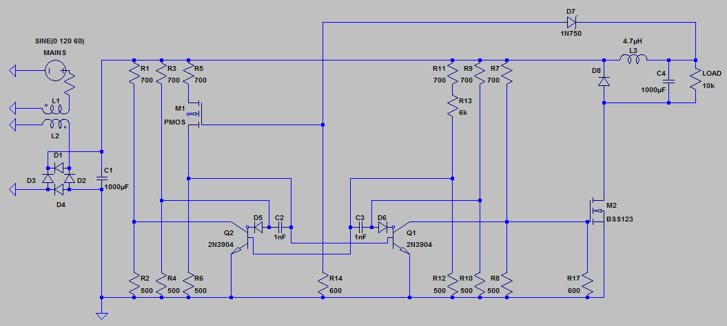

Okay. I figured I was close enough to see some kind of positive result in LT Spice. I was very wrong.
A few things to notice:
1) M1 is needs to be a DEPLETION mode P-Channel Mosfet. This is REALLY important because I'm essentially doing the exact opposite of what I want to. The function of M1 is to INCREASE in resistance from zero based on the zener feedback channel. Thus reducing duty cycle, and therefore reducing voltage.
2) The resistor connected the zener feedback channel is now AFTER the zener. This regulates the current we're pulling off of the load, AND gives us a path to ground without making the gate of M1 electrically common to ground.
3) I gave the input to M2 a resistor in a similar manner to M1. Otherwise, there would be no voltage at the gate because the gate is isolated from the rest of the transistor.
Some things I'm unsure about:
1) I can't find a depletion mode MOSFET for either NPN nor PNP type MOSFETS in LT Spice.
2) I don't know what value to use for M2's gate resistor.
Because that's the way enhancement mode N-channel MOSFETS work! Unless it's specifically a 'logic-level' type, the FET will generally need a Vgs of at least 10V to turn it on fully. If it doesn't turn on fully it will run HOT.
