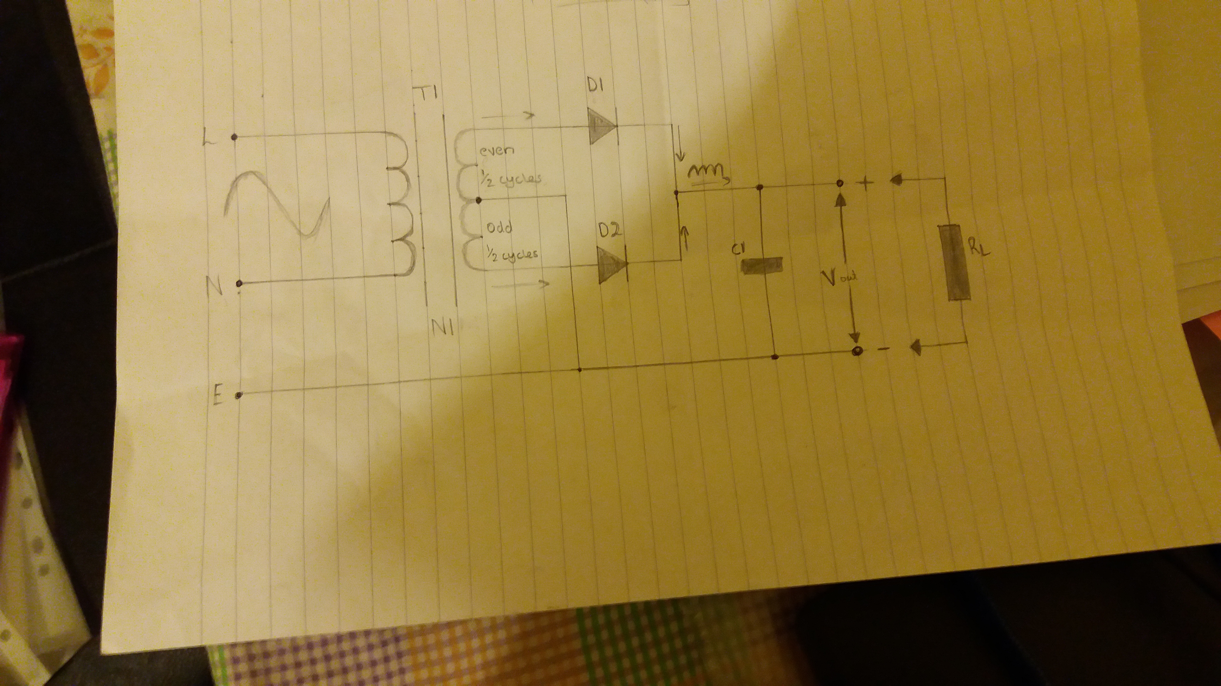

So I have to create a circuit diagram for a power supply for homework. I spent a whole week (quite literally) trying to find a solution to this question but i just can't hence I'm on here.
You might not believe me but my teacher hasn't really enlightened us on things like rectifier, transformers etc and expects our class to draw a circuit diagram.
Anyways here is the question.
The circuit diagram for the power supply must include these components:
1. A fuse
2. A transformer
3. A rectifier (two diodes only)
4. A reservoir capacitor
5. An rc filter
6. A ballast resistor
7. A stabilizer
Here is my attempt

When there is an excessive current the fuse melts so that it stops current flow?
I have 0 clue either lmao
Hi,
Yes, so where would you put a fuse so that it protects the whole circuit in case of an overload.
I guess they want an RC filter on the output?
I guess the stabilizer is a voltage regulator.
