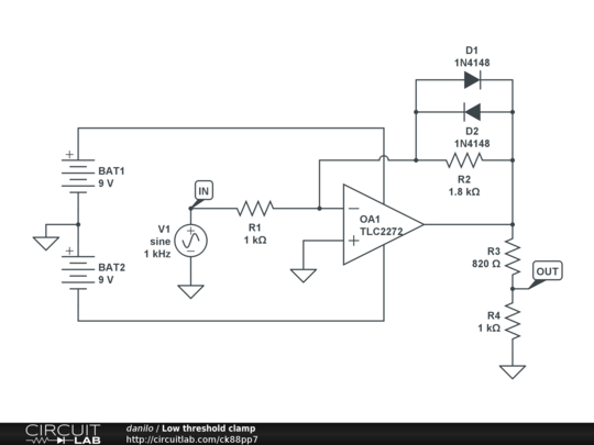

Dear,
I've already tested with new level of LED power. The problem is exactly LED power. But It is not my final goal.
My final goal is:
1. Measure received voltage to know how far between led and receiver.
2. Measure period and dutycycle of received signal to know frequency of LED.
So, the problem I met now is how to measure period and dutycycle when the receiver move far away from LED.
I intend to use comparator Opam (LM393/311) to force the received signal to square shape. Is this solution ok or not?
If you have better solution, pls help me.
Thanks a lot!

The circuit below should work well for clipping this kind of signal.
The signal swings below and above ground so you will have to either add a negative power supply or bias the non-inverting input up from ground. You will also do well to AC couple the signal so that the clipping is always symmetric.
The circuit above and a much more complex one are discussed at the link below.
https://electronics.stackexchange.com/questions/45439/clip-signal-with-very-low-threshold
If your duty cycle is going to be shifting around, that could affect the apparent duty cycle, particularly if the signal has long rise and fall times compared to the signal's period. To get around that limitation, A alternative to a clipping circuit to the above is to let the opamp's rail-to-rail characteristics do the clipping if that doesn't cause problems with rise and fall times. Just adding one or two AC coupled high gain stages and take the output of the last one.
