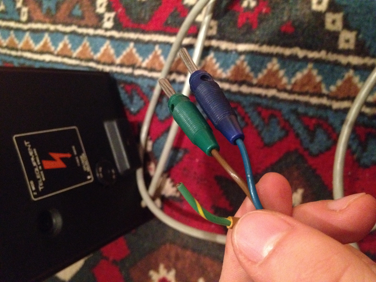

I recently got an old oscilloscope and (although it may seem a bit sad) I have no idea on how to plug it in. Instead of a normal plug, it has a couple of bananas conectors. Here you have a picture so you can see it:
So, does anyone know how to connect this to a normal outlet?

If you're sure that's a power cord, you should replace it with one with a standard plug for your part of the world. Looks like a custom rig-up to me.

Show us some more pictures of what the scope looks like, any nameplates and where that power cord enters the scope.

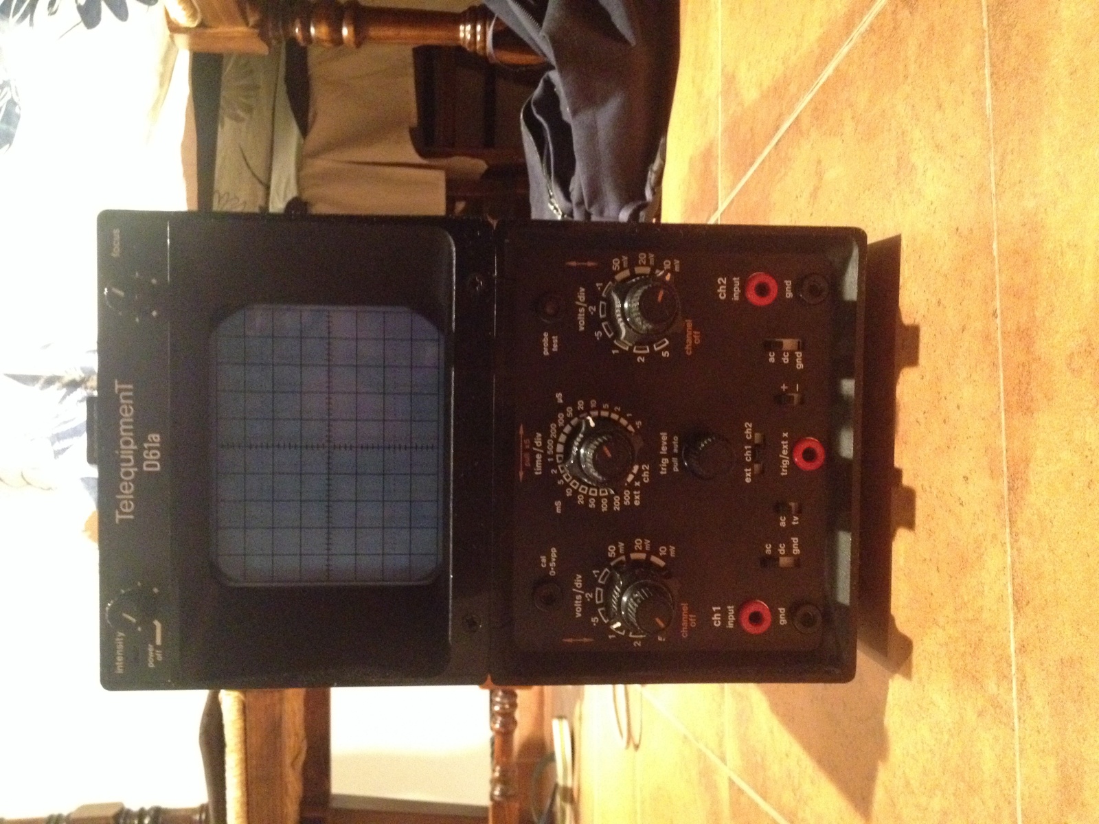

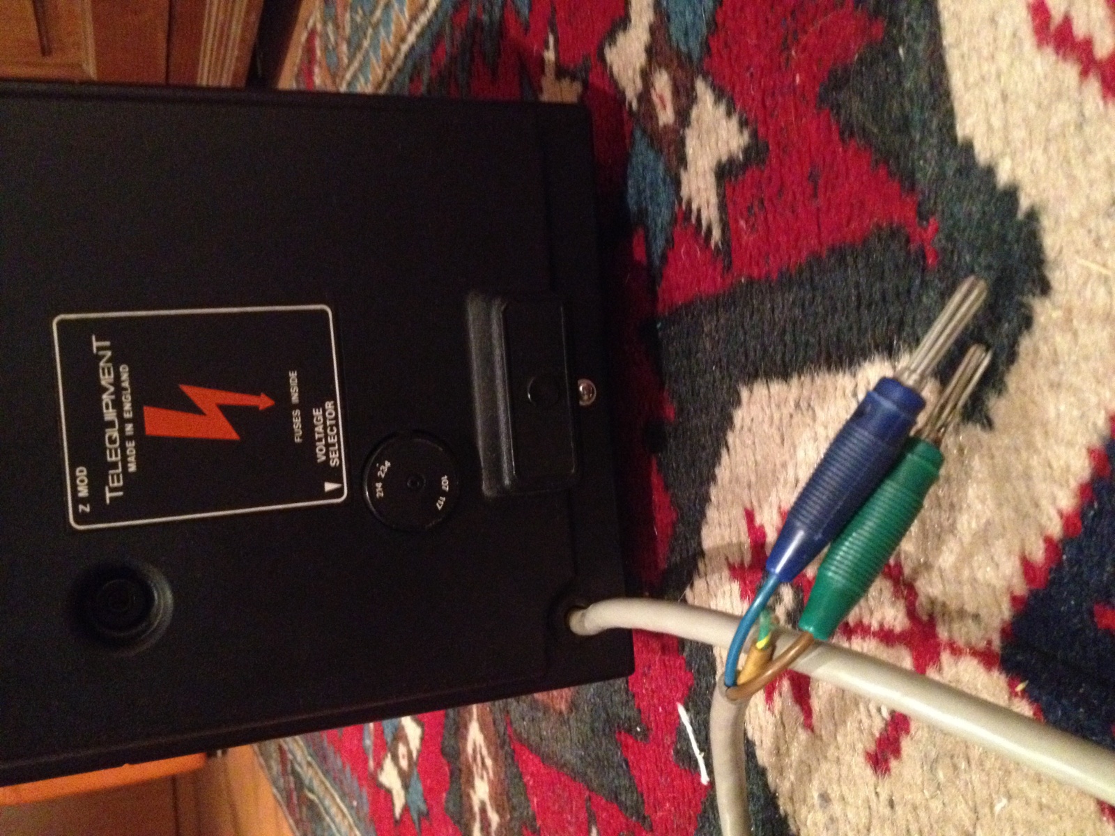

Thanks for the replies. Here are two pictures of the oscilloscope, from its back and its front. Its an Telequipment D61a (as u can see in the first picture).

I have two of those oscilloscopes, they are actually pretty good!
Set the rotating switch voltage selector on the back to the voltage of your socket (between 200V to 240V)
Take a normal plug socket and connect the brown wire to live
Connect the blue wire to neutral
Connect the yellow green wire to earth
Im not sure what fuse you will need but 5A should be fine. If it blows use a 10A
All done!

Well blue(neutral), brown(hot) and stripped one is ground.You should buy standard euro plug and use it with plug, currently you are playing with your life if you plug it that way.Two holes in the socket are Hot and neutral, ground is two pins on the sides of the socket.

Since the plug can be inserted two ways don't be too concerned about the blue & brown colors.
Just make sure they go to the prongs and the striped one does not! It goes to ground.
