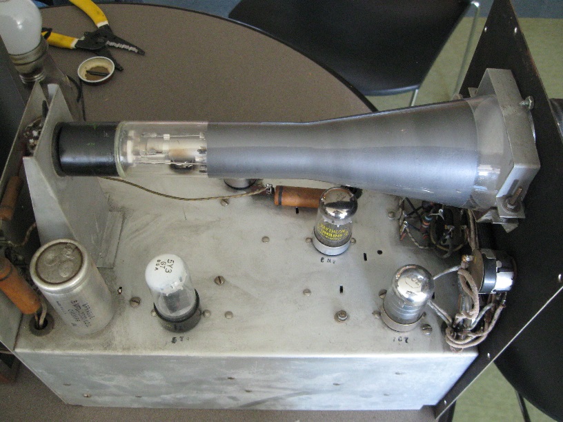

Ok, so I took this thing apart again and snapped a few photos.
Here's the inside of the scope:

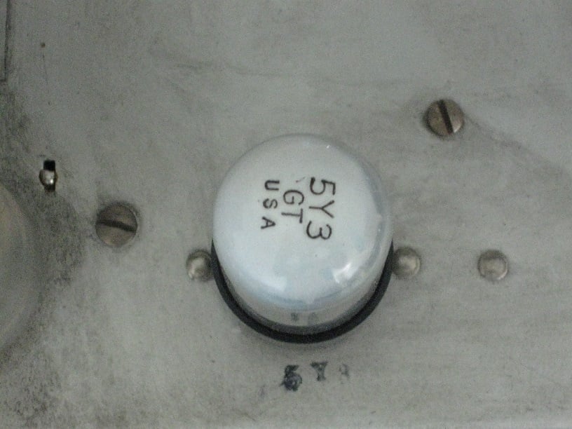

After looking at the tubes again I noticed one I hadn't noticed before: The rectifier tube has a large white spot at the top. I expect this means that air got in to the tube:
That tube also seems to heat up more quickly than the others, and stays warmer for a longer period of time after the scope is switched off. I have a feeling this rectifier is blown, which I believe would cause the display to not work at all. Am I correct in this assumption?

Ok, so I removed the tube and did notice a small crack in the glass, down near the base. I found a new one on ebay for $0.99, plus $6 shipping, so I went ahead and ordered that. I'll post some photos when I get this thing working :)

Hello,
Yes, it looks like that tube has some air in it.
The air will cause the heater to burn.
It will not heat up after some time, as the heater will be burned.
Bertus

I would also replace the adjacent can capacitor. It may work with the existing one, but caps, especially electrolytics, deteriorate with age and lack of use. They can fail in spectacular ways.
#12
Joined Nov 30, 2010
18,224
A 5Y3 is still a common enough tube. Better to keep it as is to avoid the B+ arriving before the other tubes are warmed up. Still...
You could replace it with silicon diodes if the peak voltage doesn't get too high for the capacitor during warm up, and you would have to add resistors to keep the B+ voltage from being too high continuously. (I've done it.) IIRC, that one needs about 80 ohms in series with each silicon diode. Just in case the day comes when you can't buy a 5Y3.;)
