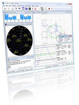

http://www.visualgps.net/visualGPS/default.htm
That freeware above looks ok, and has the circle map showing the satellites position. Not the same freeware I used before but it looks better with more features. :)

Regarding your comment "GPS sats in view" when they spit out the data, can you explain how the tracker knows what angles to move to, without any math/s being required, please?
Check this page;
http://aprs.gids.nl/nmea/
it is a good reference of the text data spat out by most GPS modules. You module won't output every NMEA sentence, but it will output the satellites in view.
Check out the sentence;
$GPGSV
it has data for every GPS satellite in view. You can use these two data fields;
5 = Elevation in degrees, 90 maximum
6 = Azimuth, degrees from true north, 000 to 359
which show the satellite position relative to your GPS ground position. To point at that satellite just turn the rotation motor to match 6 (Azimuth) and the elevation motor to match 5.
Your antenna will then be pointed at the satellite. No maths required. :)
(edit) The PC freeware I linked to in a post above uses that elevation/azimuth data to show the satellites on a circle map. The GPS outputs those two data fields for every satellite in view, so the software shows them on a little circle map of the "sky".
