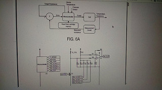

It should but there is a restriction in air flow on the fluid side (condensation chamber ) so the pressure equalization is not instantaneous during rapid ambient pressure changes.
Somebody has to make the chips that control (some have closed loop temp control) the fancy Vap pens ;), so there is data about possible operational failure modes and countermeasures in the controllers.
https://patents.google.com/patent/US9549573B2/en
The printed circuit board (PCB) may comprise a microcontroller; switches; circuitry comprising a reference resister; and an algorithm comprising logic for control parameters; wherein the microcontroller cycles the switches at fixed intervals to measure the resistance of the resistive heating element relative to the reference resistor, and applies the algorithm control parameters to control the temperature of the resistive heating element.
The micro-controller may instruct the device to turn itself off when the resistance exceeds the control parameter threshold indicating that the resistive heating element is dry.
The pressure sensors are very similar to microphones.
