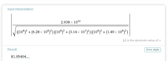

Ok, so now I understand this better. We approximate the three stages with a dominant pole (p1 = 238.1 kHz) and as long as the frequency is close to p1 we can use transfer function for 1st order LPF to find the gain magnitude. That's why our whole circuit can be analogous to a simple inverter circuit... Otherwise, if the frequency is too far away from p1 we use the entire transfer function? So, my mistake was that I did not take the magnitude of the transfer function... Another question that I have is finding the GBP of the 3 stage circuit. I keep fiddling around with the numbers but cannot get to the 4.2 MHz frequency which seems to be the answer. Any help with that would be appreciated!
P.S. sample calculation of GBP is below in pdf
https://db.tt/pqPJqoJx
The Electrician,
Here's what I plugged in:
You need to get a correct expression for the overall transfer function.
Fix up the expression you have above. Substitute jω for 10^6 in each of the three subexpressions.
And if you're going to be evaluating in terms of frequency in Hz, rather than radians/s, substitute (2 j pi f) for jω.
Apply the function ABS to the final result to get the magnitude.
Do this, and show your result. Evaluate it for f = 1 MHz and show the result. Then we can proceed with the rest of the problem.

Here's what I have:
If we approximate by the p1 dominant pole frequency we get something close...
Now, if we do this at 1MHz = 6.28E6 radians/s we get,
The approximation by the dominant pole method is pretty bad once we evaluate at 10^9 rad/s...
So, now my next question is at what frequency is the GBP for the circuit? I keep getting different values from 4.2 MHz.

By the way if I just plug 10^6 in for omega into the transfer function I don't get 85
Hi,
Hey, I just realized you must have not read my post #8 or didnt understand it.
I had written this formula:
A useful formula is:
Vout/Vin=w1/sqrt(w^2*G^2+w1^2)
where
w1 is the gain bandwidth product (like 1000000 for example),
G is the set gain of the stage (like 10 for example),
w is the operating frequency.
All you need to do is use that formula three times once for each stage gain G, and multiply the result by the product of the three gains. That is because they are all in tandem.
Your w1 would be 5e6*2*pi, and for 1MHz w would be 2*pi*1e6.
For stage 1 the gain G is 5, stage 2 is 1, stage 3 is 20, and adjust for sign.
This is nothing more than the more common:
w1/sqrt(1+w^2/(w1/G)^2)
however these are both estimates (and pretty good i think).
The more exact formula is:
G/sqrt((w^2*G^2)/GBW^2+(2*w^2*G)/GBW^2+w^2/GBW^2+1)
or in Latex:
\frac{G}{\sqrt{\frac{{w}^{2}\,{G}^{2}}{{GBW}^{2}}+\frac{2\,{w}^{2}\,G}{{GBW}^{2}}+\frac{{w}^{2}}{{GBW}^{2}}+1}}
where GBW=2*pi*5e6 for this problem.
and this is written out in the second form so you can easily compare it to the more common estimate form, and see there are two extra terms under the denominator radical. This form usually isnt necessary because the open loop gain is always somewhat of a variable too, being high but not being exactly defined. Since the GBW is defined but the open loop gain is not, we assume the open loop gain is perfect, which means it is at infinity. The GBW still controls the response however.

Ok, analytically i get 4206746.39Hz.
That's after modifying the formula for a non inverting stage and including two gain factors like that and one for inverting.
So the formula for the inverting is:
(G*GBW)/sqrt(GBW^2+w^2*G^2+2*w^2*G+w^2)
and the formula for the non inverting stages is:
(G*GBW)/sqrt(GBW^2+w^2*G^2)
Because there are two non inverting stages and one inverting stage we have to use the first formula once and the second formula twice in order to arrive at an exact figure for this setup.
The funny thing is, doing it this way we get a gain of 16.059994 at 1MHz.
After a redo, the single stage approximation comes to to around 23 or 24 depending on which formula you use above. The simulation shows closer to 16 however.

Anyway, this is what I got when I used the formulas provided:
https://db.tt/trlNSZ7c [Wolfram alpha]
Also, at 1MHz = 6.28E6 rad, by the approximation formula, I got 0.16 which becomes 100*0.16 = 16...
