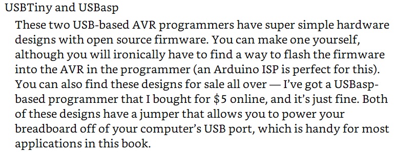

  8. LightningWalrus
    Thread Starter New Member
    Mar 15, 2016
    26
    0
    I've never used arduino. And i'm not planing into using Arduino IDE and Atmega328P with bootloader.
    I want to program Atmega128A in C by writing the code, compiling it and uploading it to the chip with a programmer.
    Would USBasp transfer compiled C code (machine code) into microchips flash memory with no additional hardware and any problems i should be aware of ?
    There was some reference to USBasp in the book which i'm looking at.
    [​IMG]
    Is that for all USBasps or only ones that you make yourself ?
  9. ISB123
    Well-Known Member
    May 21, 2014
    1,240
    545
    USBasp would program the microcontroller just fine.
    LightningWalrus likes this.
  10. shteii01
    AAC Fanatic!
    Feb 19, 2010
    4,419
    696
    Are asking about flashing the chip in the programmer? Yes, it is chicken and egg problem. I ran into the same thing when I was looking into building my own programmer. I pretty much found all the programming circuits you have found, but once you start reading though the instructions, you find that you need to somehow program the chip in the programmer that you are building...
    In my case I started looking for chip that has a bootloader on the chip from the factory. I already had some experience with Intel 8051 uC chips from school, so I found a couple of 8051 chips that come with bootloader from factory (Microchip and Maxim). I chose Microchip chip. However, these are not AVR chips. If you use AVR chips, like I wrote earlier, just getting cheap copy of some Arduino board would serve you very well, you can use that board to program other AVR chips and you can use it for projects.
