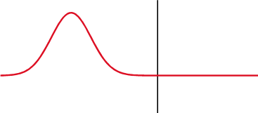

The answer is "refractive index differences and Fresnel Equation".
The gap between glass and image must be traversed twice and you get attenuation both times (when there is a gap). There is effectively no gap and no refractive index mis-match when the image is pressed into the glass.
The greater the mismatch in refractive index, the greater the loss by reflection vs transmission through the glass. Notice the loss in intensity upon transmission.
https://en.m.wikipedia.org/wiki/Fresnel_equations
https://en.m.wikipedia.org/wiki/Refractive_index
Also, look here, the attenuation of a single pass is noticable, now think about how that attenuated light will be further attenuated by only reflecting the colors of the image and then again attenuated by the fresnel effect as that light comes back into the aquarium. Not much is left.
