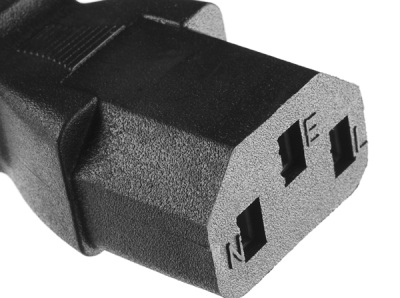

Make sure your unit has one of these AC power receptacles:
that mates with the proper AC power cord that you find on desktop computers:
Conform with the markings on the cord and connector:
N - NEUTRAL - White
E - EARTH - Green
L - LINE - Black
