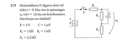

Find the voltage at specific time

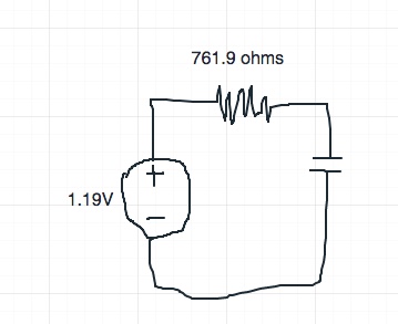

Or we can use this equivalent circuit
When I replace the capacitor with a voltage source at t = 1ms
Yes thanks that's what I got with my calculations also :)

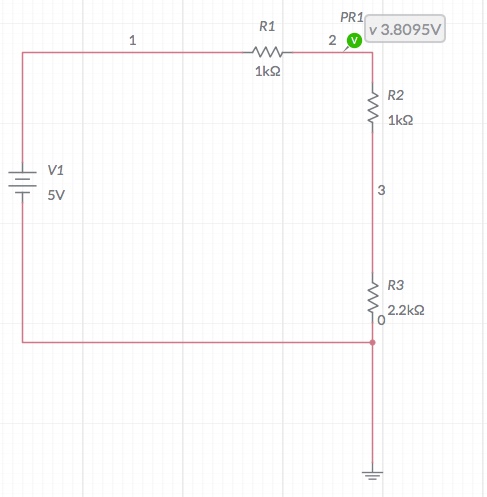

So now I know that the Voltage across R2 at t=0.001 is 0.87 V, and that at t=0, the voltage is 3.43 across R3 or Ux.
But what is the voltage at R3 at t=0.001?
I need that also since Ux is R2 + R3 at t = 0.001 :/

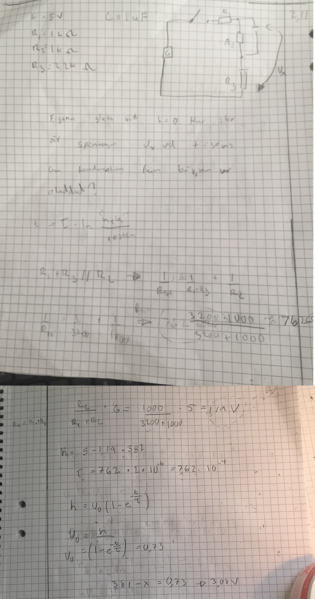

My thinking so far
To get the supply voltage for the capacitor, Vs , I look at the circuit at t = infinity
R(total) = 4200, I(total) = 1.19 mA
V(R2) = 1000 * 1.19 mA = 1.19 V
V(R1) = Vs
The voltage across the capacitor is then: (at t = 0.001)
Vc = Vs(1-e^(-t/RC))
Vc = 0.87 V
To get the Voltage Ux I want to calculate the voltage across R1 at t=0.001, then subtract that voltage from 5V.
I use superposition to remove the voltage source 0.87 V (the capacitor).
With current division I(R1) = 762 / (3200 + 762) * 0.00656 = 0.00126 A
I don’t know how to get the current across R1 if I remove the voltage source 5V.
However if I take 0.00126 * 1000 = 1.261
5V - 1.261V = 3.738
So maybe I’m thinking right here? My guess is if I also could do the superposition without the 5V (and subtract the currents across R1 at t = 0.001) I would be closer to 3.71?

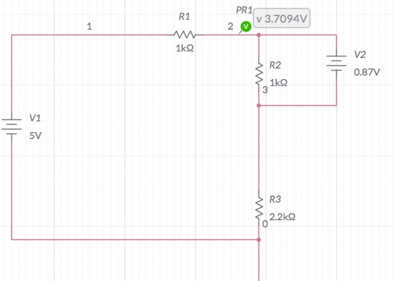

Jony130
Joined Feb 17, 2009
5,599
Very good, but shouldn't you show how you got the time constant too?
I simply find the resistance seen from the capacitor point of view.
Try to use the superposition and try to find Vx for two cases. The first one without 5V source (short circuit) and the second one without Vc1 source (short circuit instead).
Vx = Vx1 + Vx2 = 0.272V + 3.4375V = 3.7095V

To get the final answer I got the current across R2 at t=0.001
With only 0.87V source
IR2 = 0.87 / 1000 = 0.00087
ITotal = 0.87 / (R1 + R3) // R2
I
1 = ITotal - IR2 (I1 Is across R1 and R3)
With only 5V source
I2 = ITotal = 5 / (R1 + R3) = 5 / 3200 (no current across R2 here since there's no voltage)
With 0.87V and 5V source
I = I
1 - I2
V1 = R * I
U
x = 5 - V1
Ux = 3.71 V
