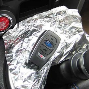

I was reading this article today.
Usual lowest common denominator mass media content, with such mind-numbing statements such as "Copying code from key fobs isn’t difficult. And this is something the auto industry and insurance companies are monitoring closely."
To the point, they mention Faraday Bags. My question is whether anyone knows of some actual tests on the effectiveness of say:
One of these (~US $58) vs. one of these (~US $1.88) vs.
one of these
or one of these?

I was interested in whether or not some good tests have been conducted to compare the various devices with their ability to prevent transmission by that device. To cut to the chase, is a tin can as good as an expensive Faraday Bag? That is what I was getting at.

Apart from EMP "bomb" concerns (which is not what I hoped would be the subject of the thread), the use of some kind of shielding, like a Faraday bag is becoming (or maybe already is in some places) SOP in many forensic situations.
edited to add: My curiosity is not about forensic uses, but rather privacy and anti-hacking...and it is just a curiosity
I am curious about the degree to which these bags, as compared to other devices like coffee cans, provide shielding. I am surprised that there are not data all over the place about this issue.
What I have been seeing is typically something like this:
"Products geared towards preppers or consumers may not offer adequate shielding or account for forensic needs. Forensics is already difficult - don't leave human error in the picture!"
Does anyone know about a site that conducted objective tests about the relative shielding capabilities of example Faraday bags, coffee cans, pain cans and the like and actually published the results?

Here is one example (pdf here). I have not read it thoroughly, but the graphs do not speak well of tin cans and aluminum foil.
This one (pdf here) looks like about a 3 hour read (for me) but gets into some interesting aspects and, from the abstract, suggests that not all Faraday bags are what one might think they are.
Actually, having now read the first cite, aluminum foil and a tin box actually looked decent - better than most of the bags tested - against 3G/4G/WiFi, but a single bag tested really looks like it does the job ($30-$300 depending on size, up to duffel bag if I am looking at the right adverts).
