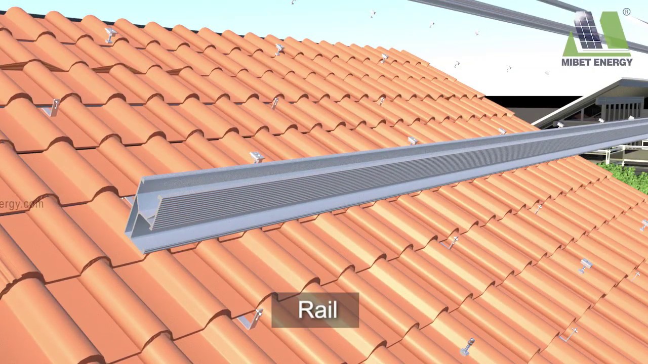

TBH, I have no idea how solar panels are installed here in S. Florida. Here's what Grok says; it's definitely not a DIY project:
"How are solar panels attached to a barrel tile roof in south florida such that they meet hurricane building codes?"
Solar panels on barrel tile roofs (Spanish-style curved concrete or clay tiles, very common in South Florida) are attached using specialized racking systems that meet the strict Florida Building Code (FBC) requirements for High-Velocity Hurricane Zones (HVHZ). Parkland, FL (Broward County) falls under these rules, which reference ASCE 7 wind-load calculations for speeds often 170–180+ mph depending on risk category and exact location. The entire system—including racking, attachments, and flashing—must resist extreme uplift, and products typically need Florida Product Approval (FPA) or Miami-Dade County Notice of Acceptance (NOA).
This is not a DIY job—it requires a licensed roofing/solar contractor, building/electrical permits, and often professional engineer (PE)-stamped plans showing wind-load compliance. The roof must be structurally sound (inspect/re-roof if near end of life, as solar lasts 25–30+ years).
Main Attachment Methods for Barrel Tile Roofs
Barrel tiles are fragile and curved, so you cannot just drill through them or lay panels directly on top (they’d crack and leak). Two code-compliant approaches are used:
  1. Tile Hooks (S-Hooks or Profile-Specific Hooks) – Most common and cost-effective for concrete barrel tiles.
    • Stainless-steel hooks (e.g., Unirac SOLARHOOKS for Spanish/curved profiles, or similar from IronRidge/QuickMount) are slid or placed under the lifted tile.
    • The base is lagged (with structural screws/bolts) directly into the roof deck and rafters/trusses (not just sheathing—minimum 3" penetration recommended for uplift strength).
    • Tiles are carefully replaced around the hook.
  2. Tile Replacement Mounts / FlashKit-Style Systems (Preferred for superior waterproofing).
    • Specific barrel/Spanish-profile tiles are removed at each mount point.
    • A universal base + profiled flashing (flat, S-curve, or W-shape to match barrel tiles) is installed in place of the tile.
    • The base is anchored to the deck + rafters with lag bolts.
    • Surrounding tiles interlock with the new flashing for a seamless look.
  3. Examples: Unirac FlashKit Tile Replacement (Miami-Dade NOA-approved for HVHZ), Quick Mount PV Tile Replacement, or IronRidge equivalents.
Here’s what the installed systems look like on barrel/Spanish tile roofs:
How solar panels installation on the clay tile roofs
prostarsolar.net
Tile Roof Hook for Solar Mounting System
youtube.com
And a cross-section showing how the hook/rail attaches through the tile layer to the rafter:
Customize Solar Tile Roof Structure,Wholesale
wanhossolars.com

  • Racking & panels: Aluminum rails create an air gap under the panels (for cooling). The full racking system (e.g., Unirac SOLARMOUNT) must be tested/approved for HVHZ wind loads. Panels themselves stay attached; the system is designed so failures (rare) leave the roof watertight.
wanhossolars.com
Critical Hurricane-Code Elements (Flashing, Anchoring & Wind Resistance)
  • Structural anchoring: Every mount must tie into rafters/trusses with corrosion-resistant (stainless steel) lag screws/bolts. Attachment spacing and number of points are engineered denser in high-wind zones for uplift resistance.
  • Flashing & waterproofing (biggest code focus to prevent leaks in driving rain): Follow the FRSA/TRI Florida High Wind Concrete and Clay Tile Installation Manual. Requires:
    • Deck-level underlayment flashing (often 3-coursed on all four sides of the penetration).
    • Tile-level counterflashing or collar.
    • EPDM/butyl gaskets + compatible sealants.
  • Engineering & approvals: Plans calculate exact wind pressures per ASCE 7-16/22. Many installers use pre-approved systems with NOA to speed permitting.
Why This Meets South Florida Hurricane Codes
  • The FBC (Chapter 15) and HVHZ rules treat solar as a rooftop structure that must match or exceed the roof’s own wind rating.
  • Post-hurricane inspections show properly installed systems perform well—panels don’t become projectiles when attached this way.
  • Bonus: The shading from panels can actually help protect underlying tiles from UV and hail.
Bottom line: In South Florida, barrel-tile solar installs use either code-approved tile hooks or (better) tile-replacement flashings, all lagged into the structure with multi-layer flashing per the FRSA/TRI high-wind manual. It keeps the roof watertight and wind-resistant while complying with local HVHZ rules.
IM getting to like this GOK,
yes they are the rails / mounting system we use in Europe, no holes drilled as you were worried about

fyi.
the rails are all but essential, the panels clip to then to allow expanion / contraction and isolation / reinforcments from the roof movments .
panels are strong, but brittle , the fixing system is criical to the long life of the system.
