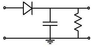

Hi all,
I am using a Peak Detector circuit (circuit shown below, with a 2.2uF cap and a 500k resistor) to envelope a signal.
The output waveform which I am getting on simulation can be seen below (black plot).
Could anyone please suggest any changes which may be implemented to this circuit for me to optain a more enveloped output (i.e. less ripple and sharper falling edge)
Something similar to what I intend to get is also shown below.
Any suggestions would be highly appreciated.

The modulation for that carrier seems to be rather a high frequency as compared to the carrier, making it difficult to demodulate without some ripples.
If the carrier and modulation are too close together, you may have to add a higher order filter to smooth the ripples.
What is the frequency of the modulation and the frequency of the carrier?

kubeek
Joined Sep 20, 2005
5,796
@Dritech I think you should first notice how many peaks are above the envelope in the first picture, and how many are in the second picture. Notice the consistency in the second one? That is the main reason why the second envelope can be much closer to what you´d expect.

looks like slower attack and faster decay to me, in other words a resistor in series with the diode to slow down charging of the cap, and a lower value than you have now parallel to the capacitor for faster discharge (see the tail after the last pulse). Note that you might need some amplification as well to get the same amplitude as your green curve.

WBahn
Joined Mar 31, 2012
33,075
Hi all,
I think you are asking for contradictory things. Lower ripple means that you want the filter to respond more slowly to changes -- i.e., you want it to fall LESS in the time after a peak before the next peak. But sharper falling edge means you want it to fall more quickly after a peak. Can't have it both ways.
crutschow
Joined Mar 14, 2008
38,680
originally it is a bipolar signal, but since the signal is being passed through a signal supply BPF, the negative part is being chopped out. I will try to find a way to rectify the signal prior passing it to the BPF.
I was asking because if you have the bipolar signal, then you can use a full-wave rectifier to detect the signal (as in the Figure 2 detector) which will double the frequency, and halve the ripple for a given detector output filter response.
For that you should use a BPF with a dual supply before the detector so it's not clipped.
