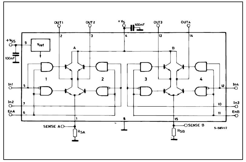

As a suggestion to simplify the hbridges, you could just buy three L298 ICs, each of those is a h-bridge and should run one coil pair. I think that would still demonstrate to the students what is happening.

Yep that's another possibility. Makes the circuit physically smaller. They are available at Futurelectronics for $2.75 each. You need two of them.
If you use them you would not need the NOR gate but still the inverters (4049).
Have a look at the datasheet. In1 would be connected to one output of the 4017, In2 to the same output, but inverted. Two coils need then to be connected in series between Out1 and Out2 (as discussed earlier). I personnally never used the L298 before, many people here did though, so I don't think there would be a problem using them.
Btw, that's still only 6 coils in total.

If using the L298 the easiest is to change the supply voltage for the LMC555 and
the 4017 to 5V. You can use a LM7805 voltage regulator for that. Refer to figure 7.
The VSS pin of the L298 will also be connected to 5V. The L298s' VS pin will be connected to 12V.
I drew the power part manually and only for one coil pair. The other 4 outputs of the 4017 need to be connected in a similar manner to the other two H-bridges. The logic inputs of the unused L298 H-bridge (in the second chip) will be tied to GND. There are 2 H-bridges inside a L298, so you need 2 ICs.
I don't have this component in my library and it's quite some work to make a custom one.
The circuit gets slightly cheaper and physically smaller. You only need to add the LM7805.
Refer also to the datasheet of the L298, figure 6.
That's the internal diagram of the L298.
Any questions just ask.;)
