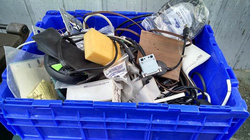

That quote can cover so much ground. Like, one man's old computer in his garbage is another man's source for recycled gold or a kid's source for electrical parts for a new homemade computer and is another man's source for someone's personal info left on the hard drive. Like you say, it all depends on your application. With 2 rooms full of hobby stuff to get rid of, collected over 53+ years, I can really relate to that these days.
MrAl
Joined Jun 17, 2014
13,793
Hi,
Oh wow yeah i can relate to that too, i have containers and containers of electrical parts that i dont use anymore. Decades worth. Might donate to Rutgers University which is not too far from here (5 miles).
It's crazy what i have collected over the years.
