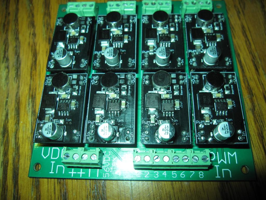

No I do not need voltage regulation since it will only be powering the LED light. I will be using a LM2576 -5 for my Mcu. What would be ideal is if I can find a switcher that can give me 5V regulated out on one pin and 12v with regulated current on the other. Similar to what the current buckpuck does but I am guessing that is asking too much. I would be happy with limiting to ~640ma with 12V in and <= 12V out.

Your board looks like it has groups of 3 LEDs in series so that's the load it has.
For the feedback values shown it regulates at about a 645mA average current with about 40mA of ripple (which would be invisible).
Replacing R3 with a 100kΩ pot would allow adjustment of the regulated current value.
The simulated efficiency was over 90%, not including any losses in the inductor.
That is what I figured too. But there are 64 LEDs so it does not add up unless they have one hanging out there on it's own. And I can't figure out where I came up with 640ma. I just dragged out the old controller and looked at the sense resistor again. It is a .33 which makes that board regulate 333 ma if I am reading the datasheet and resistor correctly . And if you do the math on the array it comes to around 440ma which would be about right for original controller. I did this 6 years ago so who knows what I was thinking. Unless I intended to rebuild the light for 640 ma and bought the 700ma buckpuck to prepare and really have it set to 330 ma. Of course I don't have any notes. ;) I guess I will have to measure it to be sure.

That is what I figured too. But there are 64 LEDs so it does not add up unless they have one hanging out there on it's own. .......................
The simulation shows the MOSFET dissipating less than a half watt so should require no heat sink.
Note that you can use a different P-MOSFET than the Si4433DY I used but it should have a total gate charge of no more than about 10pC (as shown in its data sheet) for proper switching and minimum dissipation.
Incidentally, I count a lot more than 64 LEDs on that board. :confused:

Sorry 108. I got to bed about to last night and then maybe got 3 hours sleep. :eek: So that is 720ma. I was right! :)
I might go with the zxld1360 or the original pt4115 (I have some one hand if I can just find the sense resistor without paying 200x more for the shipping). Both are tiny and low part count. And they have PWM control which I need. Actually I just need to be able to turn it on and off.
