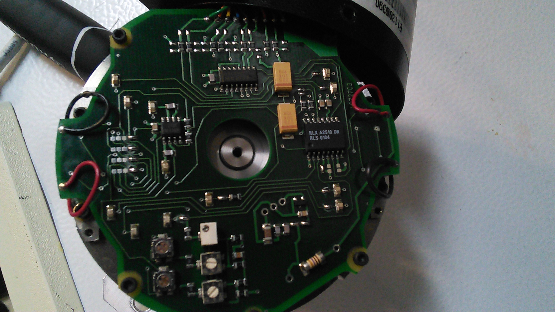

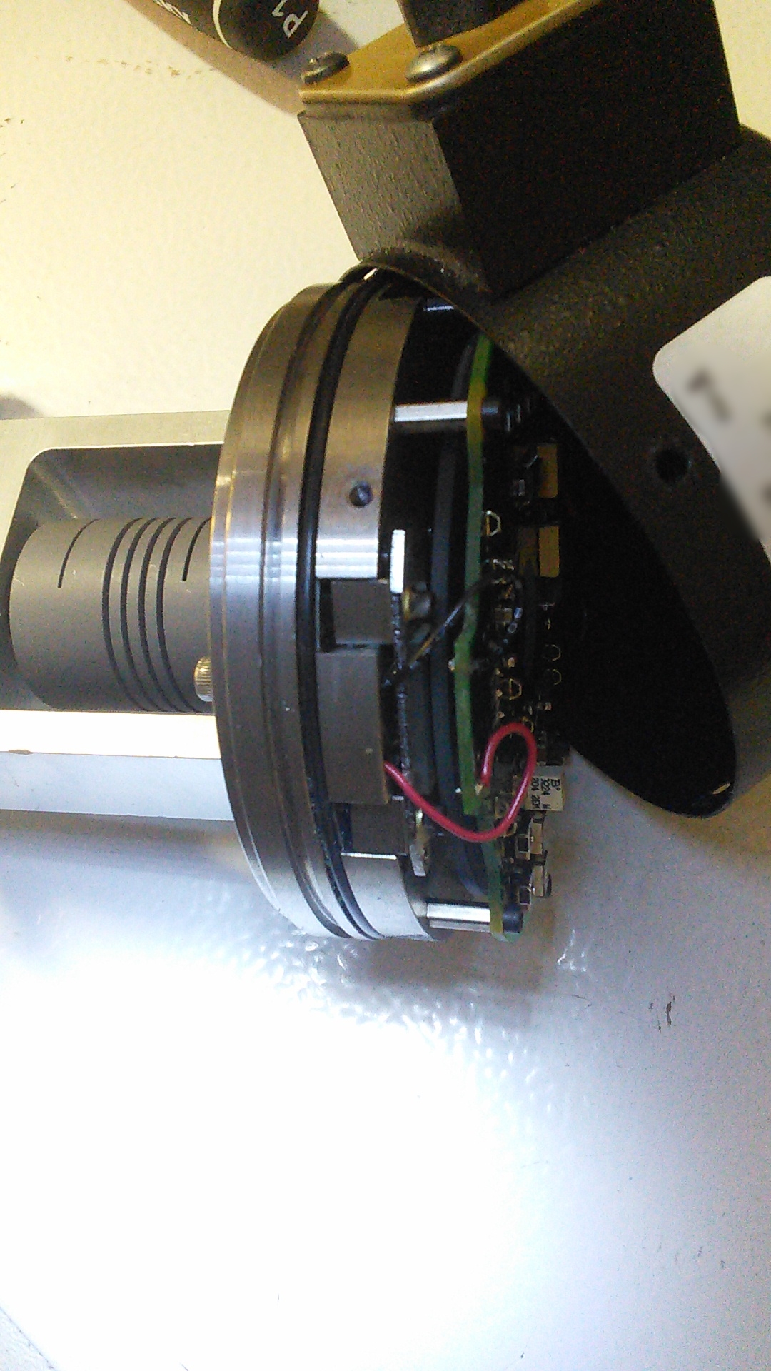

I agree on purely technical grounds but its a term of art that's used in the direct drive controllers for these types of systems as (post, 1-4x or some other term) with quadrature but (X4 logic) is also used.
Lets open the box to see what's inside. Hard for me to tell what technology they are using.
