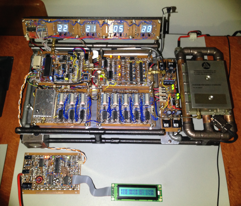

It appears I lose the first byte of transmission from the dsPic, only once at power up.
My 16F877A with UART doesn’t do that. The first thing it says is “Hi” and I see that on a terminal.
I have Tx/Rx working basically in practical application,
but haven’t looked at any UART error checking yet, which I will eventually clean it up.
The device it connects to is a slower pic micro, so comms can’t run away at the moment.

When you say that you lose the first byte. It could be either the dsPIC never sending the first byte or the slower PIC micro never receiving the first byte. I suggest a variable delay before sending the first byte to make certain the slower device is ready to receive in time for the arrival of that first byte.

No that’s tested with an old-school serial console.
I’m talking only about first byte after power, not the first byte of every string.
Perhaps I need to check the state of the UART tx pin before serial kicks in.
The astronomy algorithms at least work as they do on a bigger platform.
The top line is Moonrise/set times, and the bottom is Sunrise/set times for the day.
They happen to be pretty close to each other today, but it is correct for Eastern Australia.
I’ve yet to implement Moon percentage illumination, but do have the algorithm in C.
The dsPic gets time & calendar information from the clock.
Lucky I wrote serial terminal support so I could add the dsPic right onto it :)
It has been given a fixed geographic location for the astronomy algos, now I really need a GPS module.
