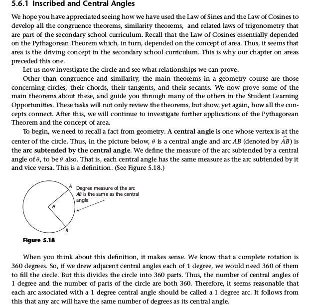

Just one thing confusing. I see no difference in the way radian and degree are defined. Both are ratio of length, so if radian is dimensionless then degree should also be dimensionless.
WBahn
Joined Mar 31, 2012
33,209
Again, where is this ratiometric definition for degree?
It must be of the form: The degree measure of an angle is defined as the ratio between A and B.
What is A?
What is B?
The degree is defined as 1/360th of the angle the constitutes a full circle. Just as (at one time) the meter was defined as 1/40,000,000th of the distance between the equator and the north pole on the prime meridian.

WBahn
Joined Mar 31, 2012
33,209
I see that as defining (and keeping in mind that any "definition" in a textbook is not definitive) what is meant by certain terms, such as central angle and arc subtended by a central angle. I don't see anything there that defines what a degree is -- it uses a prior definition of a degree and rather strongly implies that that definition is 1/360th of a complete rotation.
