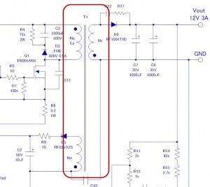

Hi All ,
I have turns details required to wind the transformer for flyback converter,but i don't know how exactly i need to wind .
clockwise or anti-clock wise what exactly is that mean please provide any document to know the directions for primary & secondary .

Look at the phase between the two coils normal practice is to make the connections in phase like
+pri -pri
+sec -sec.

Clockwise and counterclockwise depend on your point of view. I always have difficulty declaring a motor to be turning which way because you can view a motor from either end. The bottom line is, "It doesn't matter." I might say to just declare a point of view and wind all the windings the same, but you can always just connect the windings backwards after the transformer is finished and installed, and it doesn't matter which way you wound them. It only matters how you connect them.
