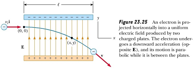

I would ask how is the electron beam deflected in a electric field so I could see the physical movement of the electrons.
http://sun.iwu.edu/~gspaldin/DeflectionByE-field.pdf
How the electron beam is formed is immaterial. We have a beam of electrons coming from the left and directed at the object. If you would like, we can focus on the initial instant in which the object has no net charge and therefore the beam is not in the presence of any electric field (other than that created by the beam itself and, by symmetry, this results in no beam deflection). As the object charges it develops an electric field that is oriented radially and, as a result, causes no deflection in the beam but does accelerate it along the path of the beam (and hence either speeding up or slowing down the electrons). Let's assume that this field never grows strong enough to halt the electrons or, even better, to ever significantly slow them down. We can always adjust parameters to make this assumption reasonable without changing the nature of the problem.

how about the way that electrons move off the cathode of a crt to the screen? repelled by the more negative charge on the cathode to the positive charge on the phospor screen? and focused by the other electrodes. and deflected by the + or- charge on the deflection plates? or by moving through the changing magnetic field of the deflection coils? how about the circuar path of the electrons in the magnetic field of a magnetron? tubes have the electrons emitted by the cathode and attracted by the plate.
What about it?
In a CRT let's say e-beam current between the gun and the screen is 1 mA (just making up a number). Is that a current of 1 mA toward the screen or away from the screen, from the "electron flow" perspective?
Actually the final anode is on the HV Aquadag coating on the inside of the CRT, the front is just a phosphor layer that the accelerated beam strikes..
Max.
16,475
"From an electron current perspective, which of the following properly describes the physical movement of charge when an electron beam is fired at the circular object shown?"
The point was not how the beam was formed but how the charges of that beam were deflected as they would be in a real device so a student looking at the arrows of b and c from your question would then believe they were equivalent with the actual trajectory of deflection when we know the physical direction of the electron from the cathode to anode and its charge.
