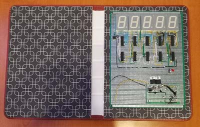

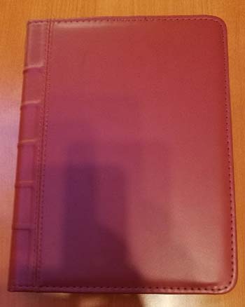

I mounting it in a small "leather" notebook shell (walmart for $4). I added a toggle for run/pause, and upper left has the momentary for reset.
I still thinking about best batt setup. I might use three smaller Li batts instead of std 9v batt. I might add a window to front cover for the display so it can be used closed or open. The toggle will stick through the front cover, it's just a tad too tall, but that's ok, this is no master-chef project ;)
