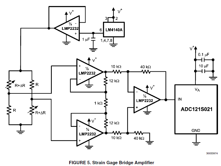

Hi All,
Struggling with a design question and how to get started with it.
A strain gauge sensor, R4, has a resistance value from 110 ohms (no deflection) to 110.7 (full deflection). I need to design a circuit that will use this sensor to produce a voltage in the range [0.0V, 3.0V].
I need to calculate the value of Vsensor in the circuit.
Let R = R1 = R2 = R3, prove that Vsensor = Vs x (R-R4)/2R.
I am struggling to see what voltage I would give Vs.
Any help would be appreciated.
Nath.

Presumable TS needs 3V FS for digitization with ADC. Adjust amplifier gain to suit. Do ADC and perform calibration in software.
You should be able to calcuate Va?
Va is the voltage on the non-inverting input of the opamp.
Next, the opamp has negative feedback and so will set its output to keep the inputs at the same voltage.
So what will be the voltage at VB?
Now you can calculate the voltage across R3 and so the current through R3.
Where does that current flow?
How to calculate Va?
Va = Vs * R1/(R1+R2) ?
What will be the voltage at Vb?

Your formula for Va is correct.
The amplifier has negative feedback and so Vb will be equal to Va.
https://www.electronics-tutorials.ws/opamp/opamp_2.html
Except:
The amplifier will have some input offset voltage - but for this question assume this is zero and perhaps state that assumption.
This will also only be true while the input and output voltages don't get too near the supply voltages. As no supply voltages are given again you can only assume that this will not be a problem.

You can write an equation for the R3, R4 potential divider with Vs at the top, Vb in the middle and Vsensor at the bottom. Rearrange that equation with Vsensor as the subject (Vsensor = …………). You have a n equation for Vb so substitute that equation for Vb in your Vsensor equation and simplify the result.
