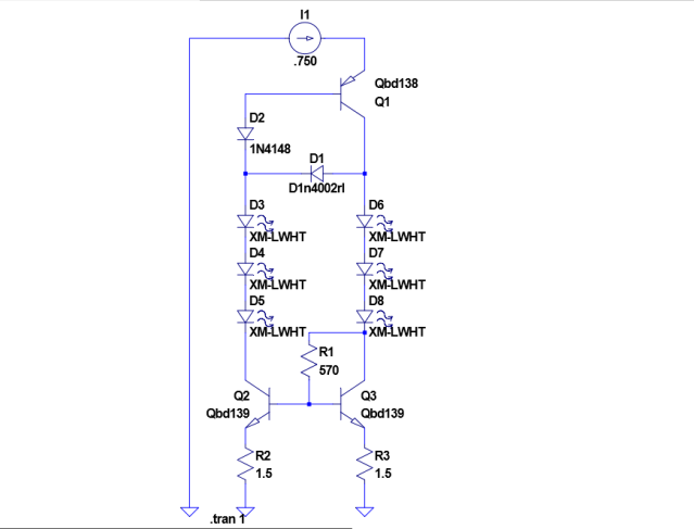

All,
I'm new to hobbyist level electrical engineering, and need some help.
I'm designing a circuit to power high power leds, instead of individual drivers and I want to power several in series/parallel.
I am using a design I found on the net, it's a current mirror, but also has protection for open circuits so that one string doesn't get
all the current if the other string opens.
The way it's supposed to work. Pnp transistor Q1 is supposed to protect the LEDs on the right side, if an LED were to open on the left, because D1 will stop the flow of base current from pnp transistor Q1. Npn transistors Q2 and Q3 protect the LEDs on the left side, if an LED were to open on the right side, because there will be no current flow through the bases of npn transistors Q2 and Q3.
The issue I'm having is when I set this up in LTSpice, and open one side, all 750ma flows through the opposite side, not working like it's supposed to is this a problem in spice or did I do something wrong?
Thank you!

When you build this, where do you plan to get a constant current source to power it? Most people use batteries or a voltage regulated supply.
With a constant 0.75a current supply, where do you expect the "other" 0.375 amps to go when you kill one string? Of course the voltage supplied to Q1 will get jacked up until 0.75 amps are forced through it no matter what happens.

As noted, the ideal current source in Spice will output 0.75A no matter what, unlike a real current source.
You need to use a current source with a reasonable voltage limit, which would be no greater than the supply voltage for a typical current source.
This can be simulated with a diode to a voltage source from the current source output.
With that, the constant current voltage can go no higher than 1 diode drop above the voltage source.

The transistor is not connected as a current mirror, it is connected as an always-on switch.
If you put D2 from the emitter to the base with the anode connected to the emitter, it would be sort of a mirror.
Using a resistor in series with each string of LEDs is much simpler, would work very well and would not be likely to kill the LEDs as much as this discreet current source.
If you really want to drive the LEDs with a constant current, try using LM317 regulators.

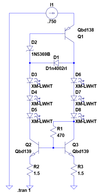

Thanks guys!
Current source was causing the maximum voltage to go over the threshold of collector to emitter limit.
It can balance the currents because of the equal voltages developed on 1.5Ω emitter resistors R1 and R2.

Here's a simple (albeit not very accurate) way of providing each LED string with its own 'constant' current source, so that failure of one string doesn't compromise the other.

But I think I've found something better, using an LT3755 because it has an option to set a over voltage limit and uses a mosfet to shut it off if it passes the limit!
I also plan to use PWM to make the bar able to dim as well.
