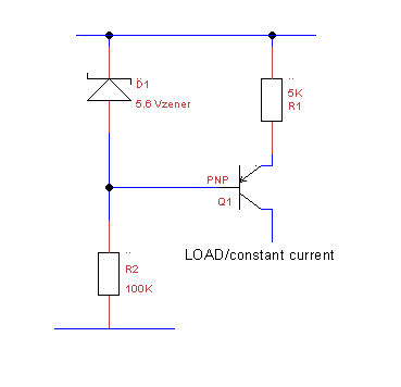

Grabbed this image off the innergoogle for illustration:
If the bottom of R2 is lifted from GND and driven with a clock, and the load is a low dissipation capacitor, then you have a stepped ramp output to feed to a comparator. Add a resistor from the base to Vcc to assure rapid turn off.

Working on the stair-step frequency divider concept now.
This is my first cut at the design, works well, but I would not use it for divide ratios of more than 10.
One element needs to be adjustable, so you can "tune" the injected current so it centers on the desired divide ratio.
Requiring 6 transistors, it's far simpler than the equivalent flip flop design, which requires 4 flip flops, containing 4 transistor each, for a total of 16 active devices, and a ton of resistors.
For low frequency operation, The caps should be bigger to compensate for leakage drift.
Will buy some large polyester caps to try next.
