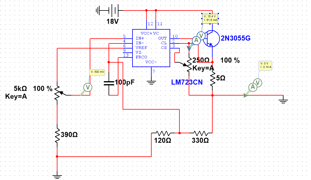

Hello again, So i got me ten turn 250 ohm pot for a crude current limit, the problem is that the pot is getting pretty hot
When 3 amps of current flows, over 60 mA flows through the pot, does anyone know how i can lower the current going through the pot? Or should i just get a better pot? Got a cheap one from ebay. Cheers.
crutschow
Joined Mar 14, 2008
38,816
Over what range do you want to vary the current limit?
Your circuit makes little sense.
How can you get 3A from that circuit? 60mA (how did you come up with that value?) through the pot means you would be putting nearly 3A through the 5Ω emitter resistor.
That would drop 15V across the resistor while dissipating 45W in the resistor, obviously not what you want.

Obviously I've got a lot to learn.. From PIN 2 down through the pot, there you can see 61 mA. If i got to choose the range i would think that 100 mA or 300 mA - 3A would be good, I'm new with the LM723, right now I'm just playing around with some random stuff. The 5Ω emitter resistor i used to limit the current to 3A. Is there another way to do it? Thanks again.

The value of the emitter resistor determines the minimum current limit adjustment.
Thus for 300mA the value would be 0..65 / 0.3 = 2.1Ω.
Say we used 2Ω which would give a minimum current limit of .65 / 2 = 325mA.
Then if you adjusted the pot to give 3A, there would be 6V dropped across, and 18W dissipated by the 2Ω resistor.
That's a lot of voltage drop and a lot of dissipation, so you might want to consider reducing the current adjustment range to make the maximum voltage and dissipation more manageable.
For example, reducing the resistor to 1Ω would give a minimum current limit of 650mA with a voltage drop of 3V and a resistor dissipation of 9W @ 3A.

Thanks for your answer, So i did reduce the resistor to 1Ω which is perfect, i got a 10W resistor so i should be good. I'm gonna stress test it for a bit to be sure that it doesn't burn up, if it does I'll add two 10W in parallel.

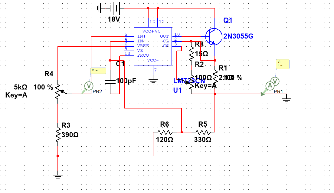

So now i have another problem, I'm sure that you already answered this in the above posts but I'm still confused about the voltage adjustment, Right now I'm using a 18V battery for the Vin (gonna change that later to a transformer with a bridge rectifier etc).I'm using a 10K ten turn pot for the voltage adjustment, but many % of the pot is useless, my minimum voltage is also around 3.5V, i would prefer 2.8v - 18v and be able to use most of the pot. What is the value for the resistors i need to change?
ignore the ratsnest to the right since the current limiting part is solved thanks to you, Do i need to change R3/R5 or R6? Or all of them? Cheers!
