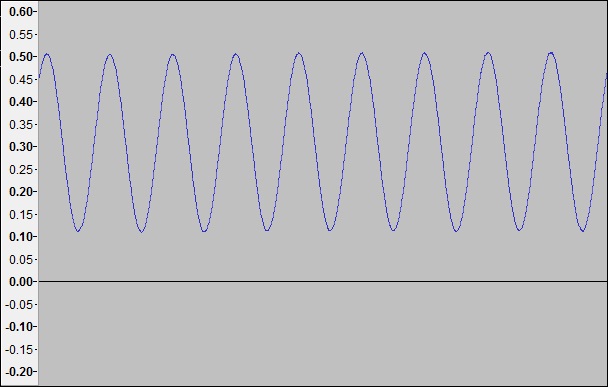

Hello All.
I wonder if anyone would mind helping me with a problem I have encountered.
I have used an Arduino to generate a DDS signal, everything on the Arduino side works brilliantly, however the output of the Arduino can only ever be between 0-5v (+ve). As I wish to use the signal for audio this is a bit of a problem for speakers etc.
The way I see it, I have two options, either use a voltage divider on the supply to fake a central ground. (ie make ground 2.5v).. And I'm also not sure this would be compatible with speakers either?
Or use some RC circuit to normalise the circuit. The problem I have with this, is that the signal could be anything between 30-6000hz making it hard not to cause filtering issues. I have also noticed a latency issue with RC techniques.
Any help would be greatly appreciated!
Thanks, James

Outputting through 20 to 100 microfarads in series with a 1k resistor should remove your DC offset.
Note the offset is DC not AC.

Jimmy7, capacitive coupling automatically puts the signal at +/- 2.5V if the speaker's other terminal is at ground.
studiot, is the 1k resistor there because the output of the Arduino can't drive an 8-ohm load on its own? Because by my math, for 30hz straight into 8 ohms, you would need about 1000uF at the output. With the 1K, it seems like he'd be getting less than a milliwatt out of the speaker.

A capacitive reactance of 100Ω at 30hz comes out at 17μF.
That is about 1/10 of 1k so most of the signal will appear across the 1k.
I don't know enough about the arduino to know what it's drive capacity is.
As you say, possible solutions (if there is greater drive capacity) would be to use a greate value capacitance.
Alternatively a higher impedance speaker, a booster amp or a transformer could be employed.

Currently, yes the speaker is effectively connected straight to the Arduino. However for this reason I brought a cheap 0.5w speaker, so I don't really care if it gets damaged (and it is an 8ohm speaker).
Currently I am just experimenting with audio signals as it's something I have no experience of. Amplifying/filtering that sort of thing.
Ideally, I want to reduce signal down to 'line' voltage range (which isn't a problem) and centered etc.
Thanks again!

Jimmy, I don't think the concern is about the speaker. If the port can't support the necessary power, it can eventually damage the Arduino.

You can construct a very simple one transistor buffer that should do the trick.
Take the supply from the +5volts not from the input supply to your regulator.
If you use the 9 or 12 volt supply from before the regulator double the resistors to the nearest preferred values.
