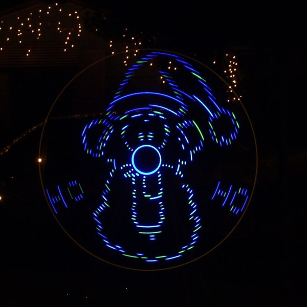

I've tinkered with inductive power transfer. I made a lawn Xmas display years ago, called Propeller Santa. A stick with 32 LEDs on it that rotated to form an image. Since it spun, there could be no direct electrical connection. Power was transfered between two coils wound around ABS pipe.
Video:
Xmas Page:
https://threeneurons.wordpress.com/links/christmas-of-the-past/
