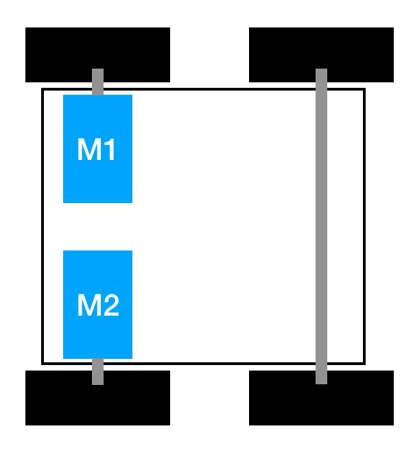

It's really going to depend on the terrain that the robot rides along. With all the gopher holes and rocks around my place, a wood frame wouldn't last too long before ripping all of the mounting screws out of the wood. But the second problem is the rigid front wheels. Unless those are omni wheels in the front, your turning radius is going to be horrible and you'll rip rubber off of the wheels whenever you turn.
Were it me -- I'd keep the wheelchair frame -- the drive wheel and the follow wheels are already mounted. Depending on the specific construction -- you might be able to separate the two sides and build something else between them, but I've only ever seen a few wheelchairs where that would easily work (wheels were mounted to a 1/4" metal plate that was then mounted to the chair)
If I were to go back and do that first project all over again -- I'd definitely weld a solid metal frame with gussets everywhere.

Hi @Mark Hughes
Thank you for the input! The omni wheels normally are very small,d=4 to 6 inches, and not get enough traction. For the design above I think it will wipe out all grass whenever it turns :D

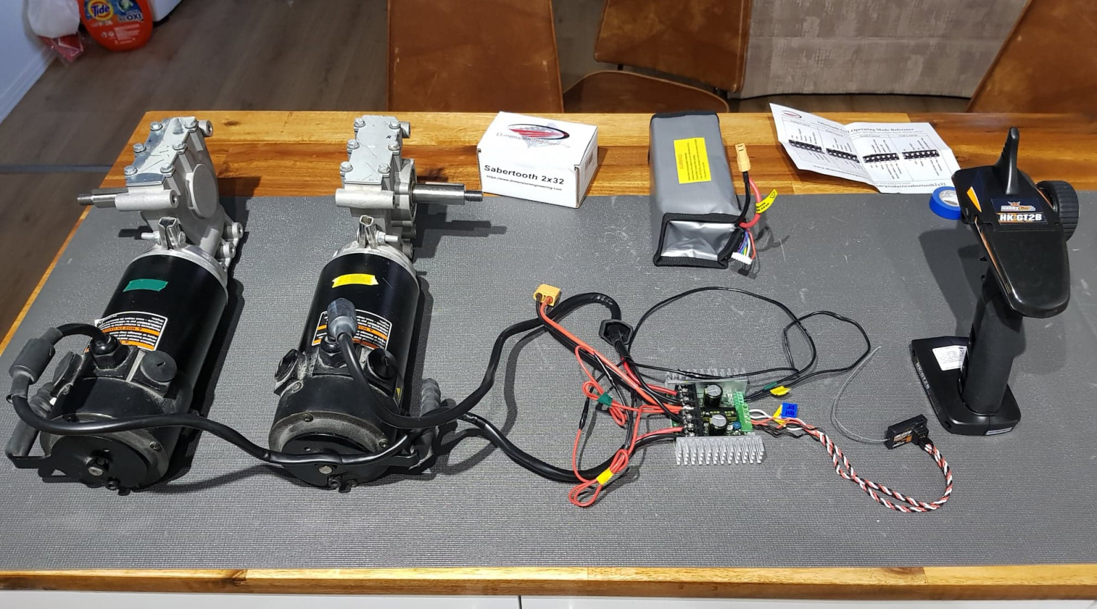

After 3 months waiting, selecting parts, my robot is 90% completed. Now it can move around, and I will attach the reel lawn mower into, for doing summer task "lawn mowing"!
I did few improvements:
1. The base of the wheelchair is very heavy, and those two wheels are not getting enough traction on snow
so I decided to use trac-drive track from an old snow blower.
2. The base, must be steel for heavy duty task! based on Mastercraft mobile base and bunches of corner brackets.
3. I decided to go with Sabertooth 2x32, very reliable and smooth motor controller.
4. Battery is LiPo 6S 10,000Ah from my e-bike!
Thank you for all your helps!
