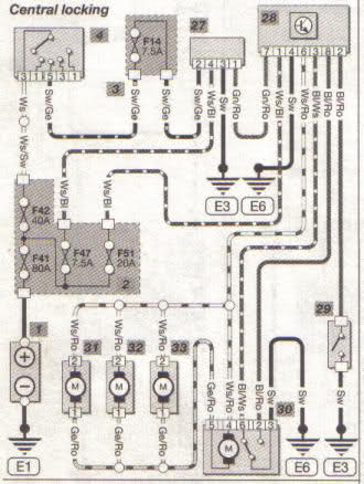

Did the auto come with remote keyless entry or is this after market installation?
Does your wiring look like this?
3:interior fusebox
28:central locking unit
30: drivers side door lock
31 passenger door lock
32 (4 door rear lock)
33 (4 door rear lock)

Your circuit has an input resistance of about 10kΩ.
We don't know what wire of the locking control you connected your circuit.
If the signal dropped from 12V to 6V, then it would appear that the signal you connected to has a resistance of about 10kΩ also.
