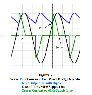

The rectifier-capacitor DC output circuit creates a non-sinusoidal current waveform in the transformer. Analogy: Instead of the nice smooth field rotation of energy flow of a V8 engine you have the thumper strokes of a Norton motorcycle. The non-sinusoidal current increases total ohmic (IR winding real resistance/power becomes a larger component of total impedance) losses because the current pulse peaks are usually much higher than the peak levels of the sinusoidal current for the same power level during one complete cycle of the waveform.
https://www.dataforth.com/rms-revisited.aspx
Some non-sinusoidal current effects on power transformers.
Ohmic losses: windings
Stray losses: eddy current, core

the maximum DC output current should be no more than about 50-60% of the transformer RMS rating!!!"
It seems I just have to take that into account while choosing the transformer, but I can't (and would like to) understand the nature of this.
It's due to the high RMS transformer current caused by the rectifier capacitor filter.
Such a circuit draws high current at the peak of the AC waveform to generate the average DC output current.
Since the power lost in the transformer winding resistance is proportional to the square of the current, this high peak current translates into a high RMS current value.
This is shown in the LTspice simulation below:
With a 1 ohm winding resistance and for a DC load current of 1.09A, the peak transformer current, I(R1), is about 3.61A and the RMS current, is about 1.77A.
The ratio is thus 1.09/1.77 = .615 (where the 50-60% derating comes from).
The actual ratio depends upon the transformer winding resistance and the value of filter capacitance, as those both affect the peak current for a given DC output current.
