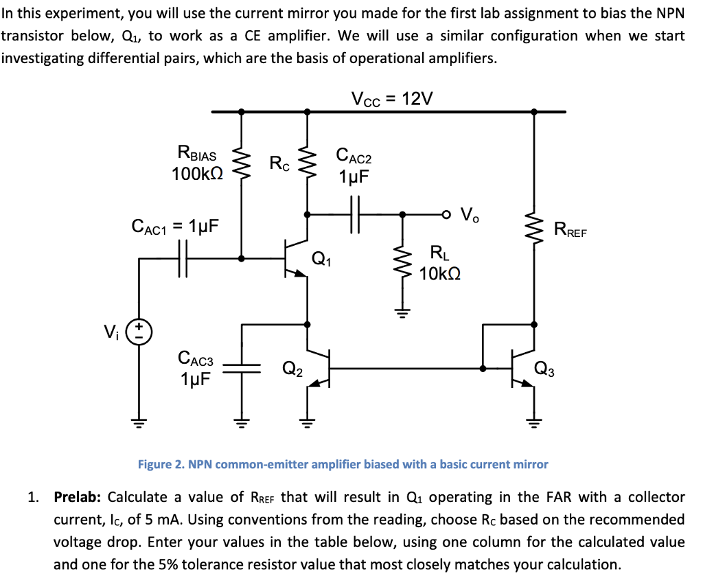

i have a question about this circuit
there is no problem with the solution i already did it but what i don't understand is why the transistor in the saturation ? since Rc = 2260 Ω and VRc ≈ 11.3 v and Ve ≈0.7v so vce ≈ 50mv
the simulation did work well too as if there is no problem at all but i don't understand how could a transistor work as an amplifier in the saturation region ??

Why did you set Rc = 2260 ohms? Don't you want to set the collector of Q1 at about 1/2 Vcc?
So you would want to drop about 6 volts across Rc, with a current (as determined by the mirror) of 5 mA. R = E/I = 6/5 = 1.2K.

Lots of missing information. I was able to kind of simulate it but it’s clipping. I couldn’t get it to linear amplification of a small input signal. But it is dropping out on the low. So sort of an signal gain. If you play with it you can make upside down Batman looking things with it.

used CA3096
Rref = 2.2k Rc = 2760
There is clipping! not working like you said
Dc voltage across Cac3 was not constant!! (0.86 - 9v)
Added 100k resistor to base of q1..Voltage across cap still not constant same as base of Q1 : not constant
Removed the Rbias from vcc and added to collector : voltage across cap still not constant
Changed Rc to 1k (voltage at collector of Q1 (4v - 9v) ) : across Cac3 still not constant
No idea why not constant : I doubled check wiring and multimeter is not bad..

Emitter of Q1 can be higher, but the output will not be able to go as low.
Yeah your R1 is 1.2k..Using 2.2k..it can go higher than 1v?
And thanks...Using 100k and 20k to bias the base of Q1 in original diagram keeps voltage across Cap constant

Fixing the base voltage with a divider keeps things a bit more stable. You need the divider to set the base voltage at > 2 diode drops (one for Q1, and one for the CC transistor). A higher base voltage will work OK, keeping in mind the output will not be able to drop much below the base voltage. Assuming you are looking for a voltage output, Rc needs to be set to maximize output swing.
Let's take a step back.
What value did you come up with for Rref?
How did you determine that value?
What is the "recommended voltage drop" that you are shooting for across Rc? Is it really 11.3 V?
How did you come up with the value of Rc that you did?
What value of beta are you assuming for your transistors?

i did it this way :
Rref = 12-0.7 / 5m = 2260 ohms and since Iref = Ic so i chose Rc = Rref but now i knew my fault if it is the same value then there will be the same voltage drop across it
i sould have chose a different voltage drop across Rc
i did a stupid mistake
