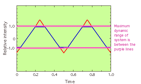

I lifted this waveform from Sonic Website. When graphed, you will notice that the rise and fall of a triangle wave are a straight line and abruptly change direction at the positive peak and again at the negative peak. Any curvature of the rise and fall lines indicate nonlinearity distortion. At some volume level, the FET amplifier in the mic will saturate (the bottom of the waveform where it can't go any closer to ground) and/or run out of "head room" and clip the top of the waveform. The difference between the saturation and clipping points is the "dynamic range" of the microphone. The goal is to maximize the dynamic range.

  • Look at the output of the mic with the O'scope. Adjust the volume until the mic output is about 0.5Vpp. The waveform should closely approximate the ideal triangle waveform.
  • Slowly increase the volume and notice any changes in the shape of the triangle wave, particularly at the top and bottom.
    • At some point, the bottom peak of the waveform will begin to clip or distort (deviate from linear). Do not adjust the volume any further.
    • This is where the FET is saturated and can't lower the output voltage toward ground any more.
  • Adjust the 10K pot up and down and notice how you can clip either the top or the bottom of the waveform.
    • Adjust the 10K pot until the waveform is centered between the top and bottom clipping points.
  • Increase the volume by a small amount. Notice the Vpp will increase.
    • Adjust the 10K pot until the waveform is centered again between the clipping points.
  • Slowly increase the volume and adjust the 10K pot until both the top and bottom of the waveform clip at the same time.
    • It is likely that the top will clip sharply, but the bottom will "mush" into saturation. This is a subjective "clipping point".
    • This is your ideal bias point for the mic. It gives you the maximum dynamic range that the mic is capable of.
    • Measure and record the maximum mic output Vpp.
    • If you can, post a screen shot of the waveform where it is slightly overdriven and looks about like the waveform I posted above.
