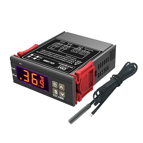

I wonder if anyone can help me with this. My vehicle, a camper van, was not able to be purchased with the optional full climate control system, so I am stuck with a manual system whereby the cooling function is turned on or off by a simple button on the heating control panel. On a recent trip to sunnier climes, this led to us alternately freezing and sweltering due to having to remember to manually control this in a timely manner.

The way mine seems to work it that the temp knob simply controls the hot water flow through the heater core and ranges from very hot air at one extreme to no heating and so ambient temperature air at the other extreme. If you want to be cooler than ambient you turn on the AC and in my experience there is no linkage with the heater setting so it will just keep getting colder until you turn the AC off.
Now it sounds like when you have the AC operating and it starts to get too cold you just turn the temperature knob up a bit but leave the AC running. However I strongly suspect that rather than that action intelligently controlling the AC all you are actually doing there is warming up the cold air from the AC by allowing some hot water flow through the heater core.
I would be very surprised with a manual system if there is any electronic linkage between the AC control system and the hot water flow control, as the latter appears to be entirely mechanical and operated by a metal rod moved by the knob on the fascia. I suppose it is possible that the other end of the metal rod operates some sort of sensor but this seems unlikely as the logical place to do this would be on the control panel temperture knob but there are no electronics attached to that knob. It appears that the only interfacing to the AC from the heater/fan controls is that if the fan speed is set to zero then the AC won't operate
Adjusting temperature by mixing heat from the heater core with the cold air from a continually running AC seems rather wasteful of the energy required to run the AC compressor which will be the case if there is no thermostat telling the AC when to run and when to stop.

Yes, we have been using the fan as a form of control. Maybe I should increase the hysteresis setting on the thermometer module to perhaps 5 or 6 degrees as that should give a reasonably long time between AC operations without allowing an uncomfortable rise in temperature.

I have now completed the wiring to access the three connections I need from the small circuit board in the heating control panel and reassembled the dashboard. The momentary switch connections are straightforward, but after tracing through the circuitry it seems that the LED is driven from elsewhere in the van's systems via the connector on the small circuit board so I could not access the supply side of its current limiting resistor as was suggested.
However, the connection to the LED reads about 12V when the LED is lit and about 0.3V when it is off. Given that the CMOS logic input is pretty high impedance should it be OK to connection this signal directly to the input of the XOR gate?
I have had a change of mind regarding the thermostat module after feedback from my wife who suggested it did not look very professional and would be out of keeping with the the van's dashboard area where it will be sited. I had to agree, so have chosen a different module. This has the bonus that it is in a larger case and has spare room inside so I can use it to house my interface circuitry instead of using a separate box, and this will make the installation a lot neater.
Yes, the gate has many megohms impedance.
But I would add a 20kΩ resistor in series with the gate to protect it in case voltage is applied to the gate if the gate is inadvertently unpowered.

Just to conclude this thread:
The device is now installed and working perfectly. Many thanks to all for the help and comments.
The circuitry is inside the thermometer case but I decided to make use of the unneeded second relay in the box, normally used for controlling heating, and by cutting one track on the pcb was also able to make use of its associated relay driver components instead of installing my own.
