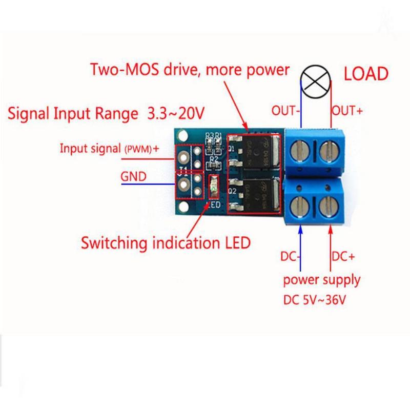

have a simple circuit that is so simple yet I get confused on the "diode" or switch control
I can supply all the details, voltages, motor volts, emf numbers, but what for....
all needed is to simply have one motor run when needed via a switch which wont affect any part of the remaining circuit
also need a flyback diode, but remember, when the switch is flipped it doesn't affect the other circuit either..
please see photo

Flyback diode is correct, but you need to isolate the motor M1, with a second diode in the Negative lead , Cathode to M1, Anode to M2, your switch can then put out a Negative pulse .
The flyback diode is well placed. Let me see if I get it.. Do you want to run M2 with the red switch, but not M1? For the sake of understanding, I would suggest to use the proper simbology when drawing schematics, specially for the MOSFET.

sorry for the lack of scematics as the Mosfet is an ebay pcb with just the connections, and cant find the schematic
its also smd and bugger me i cant trace the connections as they are also under the chips
so the mosfet just pumps out the input volgtage when the trigger is on
this is the mosfet, see foto
Let's imagine that we remove M1 from that circuit. How would you turn M1 on? Maybe it would be more clear if you explain your application on two motors in parallel, and their real purpose.
