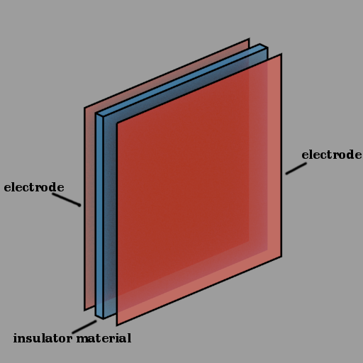

You need to change the orientation of an electric field from one angle to another. Setup is similar to an ordinary capacitor. There’s an insulator material in the middle and two electrodes on both sides of the material.
Electrodes are typically ITO PETs or ITO coated glass and the insulator is the PDLC layer.

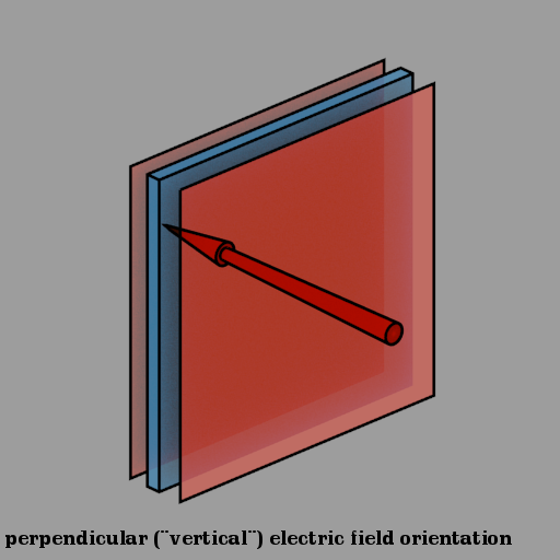

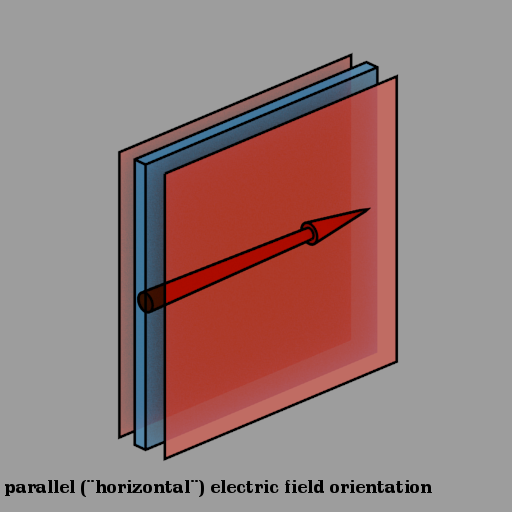

But unlike a capacitor the purpose is to change the orientation of the electric field flowing through the insulator.

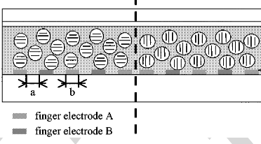

The paper describes using “two finger electrodes” on one side which is not clear to me and all I can guess is it requires one more electrode and custom electrode geometry on one side of the setup, which is possible by etching. However I’m not sure what shape is needed just by reading the paper. So there are actually 3 electrodes, 1 in one side, two in the other. But the paper makes it quite clear the whole point is just to change the orientation of the electric field relative to the insulator from perpendicular to parallel.
What geometry is needed for the “finger” electrodes? The 2d cutout diagram from the paper doesn't really show it to me, need a diagram from top view, not cutout from the side.
My guess is this is the "two finger electrode geometry":
Someon told me it's as simple as "if the plane is negative and all fingers are positive, field is perpendicular. If fingers A are all positive and B negative, field is parallel".
Is this all there is to it?
