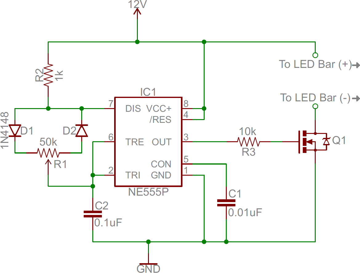

Hi Everyone,
I'm thinking of making this circuit for a project for a friend new letter box, to illuminate with Leds over letterbox numbers.
I want to make this circuit in 12 volts version.
I will upgrade the following:
Solar Panel to 12 volts @ 10 Watts http://www.rpc.com.au/catalog/cnpv-12volt-solar-panel-10watt-p-2701.html
Battery 12 volts @ 15Ah
I will change the BD140 for TIP32 as the TIP32 is to energised a 12 volt 3 Amp relay, as I'm running more Leds then below.
Do need to beef up the circuit anywhere else.
Any help would be greatly appreciated

Hi Scott,
Which suggests more LED's and a possible change of LED type.
E

53 @ 3.6 volts 20mA Leds, arranged as below.
3 amp contacts on relay Yes you're right.
Solution: 3 x 17 array, 2 extra LEDs =53 leds
3 x 17 leds
1 x 2 leds
R = 68 ohms
R = 270 ohms

When the current reach up to 100mA then it will be generate the heat, and I guess your application will be get over more, so if you considering the heat then may be using the P mosfet is another options or using a pnp and one n mosfet.

1. Why you still want to use a relay when the transistor can do the job, but maybe you will need a heat sink for the transistor.
2. if you want to using the relay then the transistor will no need so big, the 2SA684(1A) or similar transistor can do the job.
3. If you using the mosfet has low Rds then may be you don't need the heat sink and relay, because it will reducing the power consumption, you just need to care about the power consumption of LED.

OK if I use a mosfet, how do I replace it for the transistor? what type of Mosfet, eg device number?
I've no clue how wire this in the circuit.

The circuit is easy, I can do for you, also other members can do, now just waiting for your circuit and total current, and is that just 360 mA?

Can I use the Mosfet from terminal 3 of the 555 timer?
What type of Mosfet is it? as in device name, so I can buy it, please don't forget need to at least 1 amp, so I can add more Leds if I want too?

Two kinds of circuit using N/P mosfet, the n mosfet is more easy to get one to suit your need, if you insist to use the relay is ok, just don't forget to using the 2SA684 to replace the TIP32.
The below are the p mosfet to suit your need, if you choose p mosfet then you should concern the price and which one you can get.

The below are the n mosfet to suit your need.
NTMS7N03R2_Nch_30V7A_Vgs10V_23mΩ.pdf

As the 555 is now running on 12V, it will be necessary to modify the P1 and LDR , light/dark sensing.
What is the resistance of the LDR when and dark and light.?

Got No idea, as I did not noticed the value missing in the schematic, can we use 10M LDR? also will it work for the existing circuit above "ScottWang" made?
