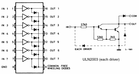

...Interesting. I don't understand all the components on this circuit. Is the ULN2003 a darlington pair device? Basically, is that just a collection of NOT gates? How can you create NAND's from NOT's?

Hello,
I have used ULN2003 yes it work as follow.
the input at in1 at 5v will give out 1 sink/gnd

***ALL*** logic devices, from the lowly 4011 to an Intel quad-core CPU, stem from the inverter, or NOT function. The internal schematics on logic gate datasheets show this very clearly, although I think TTL schematics are easier to read than CMOS. Here is the basic 2-input NOR function. This is called a "wired-NOR" connection. Additional inputs are had by adding more input sections to the pull up resistor. Thanks to De Morgan's Theorem, it is equivalent to an inverted-input AND gate. Double-inverting the inputs makes it an AND gate, adding a section to the output makes that a NAND gate, etc.
This is not the perfect logic device for everything, but when you need a little combinatorial stuff in an electrically harsh environment, this technique is almost indestructible. Your original circuit reduces to two 2-input gates, with three linear regulators to protect them plus another one to power them. The 2003 enables a less complex solution. Note that in the schematic in post #41, the three input protection zeners probably are not needed.

How would one derive the following from the ULN2003?
A NOT gate
A AND gate
A OR gate
...can you reduce the the drawing of each gate into how each gate would be created by wiring up the darlington pairs of the ULN2003?
for example, how would one wire up the chip, drawing it up like this...?
