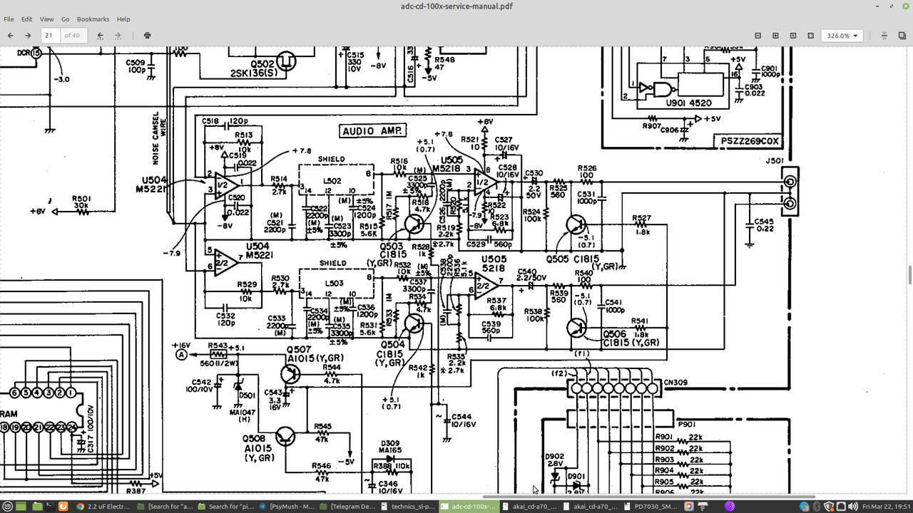

Have a look at schematic section below from a mid-80s CD player (ADC, model CD-100x).
Note C530 and 540. 2.2uF/50 v polarized electros. These are very low-cost caps if you go for electro, polarized. TTBOMK, they are used to block DC. But I'm not sure why the 50v rating. Perhaps, that's all that's avail. in this low-uF value range.
I want to improve performance. I have some high-quality Wima MKPs, in same uF, and voltage, but they are not polarized.
I also have some $$$, high-quality 35v Vishay TANTALEX
https://www.vishay.com/docs/40015/150d.pdf
If a one of these tant's is overvoltaged/abused, will it fail as an open (that's preferable!) or will it short (not good)?
BOTTOM LINE:
What might go wrong, in a worst case scenario, if one does not follow the OEM schematic (below)? E.g., don't want to blow anything up that the CD player is connected to, like a preamp or receiver input section. Or, at least, minimize noise and hum.

The polarized capacitors were used because there is DC present at that point. Not a whole lot, but some. and in some instances it is wise to not use the bare minimum value of voltage rating.
I CERTAINLY would not choose to risk having DC present on the output of a pre-amplifier that might be used to drive a direct coupled amplifier. Of course, I would never choose to own a direct coupled audio amplifier. In addition, there may be some other characteristic that is not so obvious. And why choose a non-polarized cap when there is some DC present. AND it may also be that there were a lot of that device on hand and it was the required value. Besides all of that, the designer may have known something that we don't know.

Never use Tantalum capacitors on audio - noisy old things.
Nothing wrong with a polarised electrolytic on audio, as long as it has a DC voltage across it, and it is not used as a filter (i.e. 1/(2πRC) is not within the audio range.
The first question to answer is whether the op-amp that is driving the output is contributing more or less to the output noise and distortion as the capacitors might.

C530 and C540 at the low voltage audio are not critical. 10μ/16V aluminium electrolytics will be fine.
Don't use tantalum as already stated.

The output coupling capacitor is 2.2uF. It is a highpass filter with the input impedance of the input of the amplifier.
If the amplifier input is very low at 10k ohms then harmonic distortion of extremely low frequencies below 7.3Hz are increased a little because the highpass filter attenuates those very low fundamental frequencies.

Ialready suggested that the polarized was because there was a DC bias voltage on the one side.
13hm13
Joined Jun 1, 2023
75
For the new poly caps , I measured 0.05vdc at output jack and 0.5vdc before cap.
The polarized electrolytic at that 50v value is what is cheaply available for 2.2uf. The opamp rails are +-8v.
Those cheap electros are also small and fit nicely onto that budgeted pcb area.
