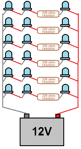

Hi all:
I need to make a circuit with 3 LEDs in series, with a 220ohm resistor and 12V source. Can I put the resistor "in-between" any of the LEDs?
I know the typical layout is:
12V (+) power--------220ohm resistor---------LED1------LED2-----LED3------(-) ground
but can I do it like this:
12V (+) power---------LED1------LED2-------220ohm resistor------LED3------(-) ground
Will this result in any of the LEDs being overloaded in either voltage or current?
Thanks in advance!
-chris

Just to check, replace each LED with a 100Ω resistor. Do a simple Ohms Law calculation applied to the two scenarios.
See if there is a difference in the voltage across each resistor and current through the resistor.

As long as everything is in series, it will work.

What's the reason you want to put the resistor in series between the leds?
For a 3V/20mA/5mm led, using 80% of led rating current and it will be:
R = (12V - (3V*3) )/16mA
= 3V/16mA
= 187.5 Ω, choose 180 Ω
For a 2V/10mA/3mm led, using 80% of led rating current and it will be:
R = (12V - (2V*3) )/8 mA
= 6V/8 mA
= 750 Ω, choose 750 Ω

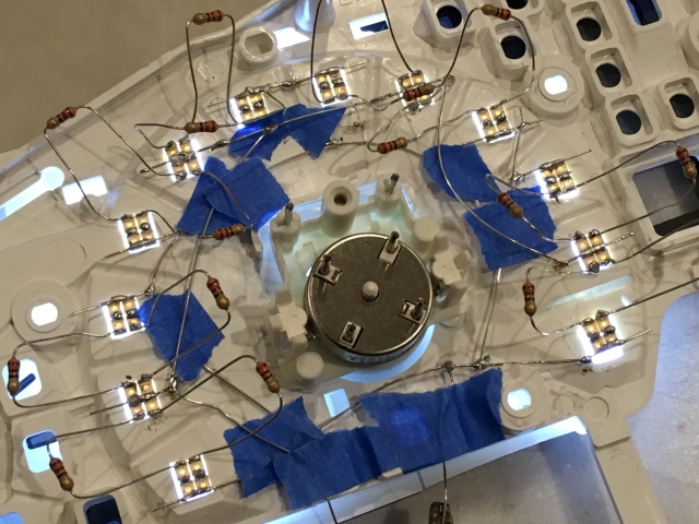

Guys, you're awesome!! It WORKS!
A project I'm working on requires me to have several clusters of 4 SMDs, in 2 x 2 squares. But i could only have 3 in series, not 4.
I first did this with 4 in series, but the source voltage wasn't enough, divided by 4.
Here was my design (after you all confirmed it for me):
And here is the proof of concept!
What do you think?
