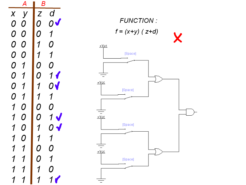

  4. halakula
    Thread Starter New Member
    Jun 3, 2013
    2
    0
    Thanks for your replies and correcting me. Problem is that since you replied I'm trying different combinations but non of them seams to work based on truth table. Is there a formula in which I can find the solution or should I try and try until I find it. Or there isn't any solution at all!
    [​IMG]
  5. WBahn
    Moderator
    Mar 31, 2012
    23,584
    7,214
    Do the blue check marks indicate when you WANT the output to be True? Or when is IS True based on your circuit?
    If it's when you WANT the output to be True, why do you have the case A=01, B=10 and the case A=10, B=01 checked?
    You give no indication in your schematic of which signal is X, Y, Z, or D.
    Please don't make us guess at all of these things. We are not mind readers and our crystal balls don't work worth a damn. When you want free assistance from strangers, you need to put forth the effort to make it easy for them to see what you are thinking and doing. Otherwise they will just find some better way to spend their time.
    Where did your function (x+y)(z+d) come from? What is your thinking behind it?
    Given your stated goal, that you want the output to be high when A equals B, phrase that statement in terms of logic concepts, such and AND, OR, NOT and so forth.
    Here's a start:
    1) The output should be HI when A and B are equal.
    2) A and B are equal when (something involving x and z) AND (something involving y and d).
    Rewrite the phrases in parentheses along the lines of the first statement and then write statements 3 and 4 to have a similar relationship to those phrases that statement 2 has to statement 1.
  6. djsfantasi
    AAC Fanatic!
    Apr 11, 2010
    3,849
    1,403
    Take a look at the rows 1001 and 0110
    I don't think they should be checked. Also, instead of checks, make a column with 1s in place of the checks and 0s elsewhere.
