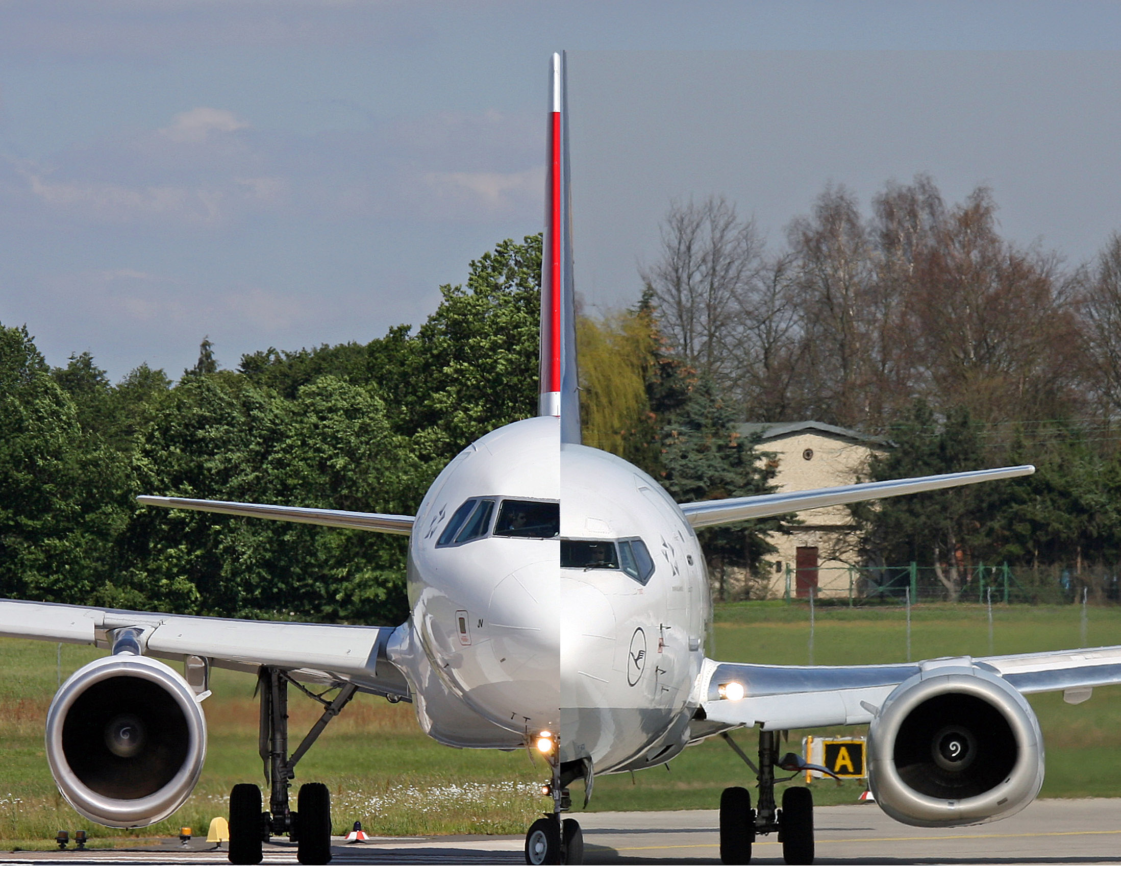

I wonder if passengers will avoid it. It certainly looks odd with the engines forward on the wings, what a lash up.
Someone said "if it looks right it will fly"... Well it does fly I suppose.
16,481
Perfectly normal configuration for a modern airplane.
